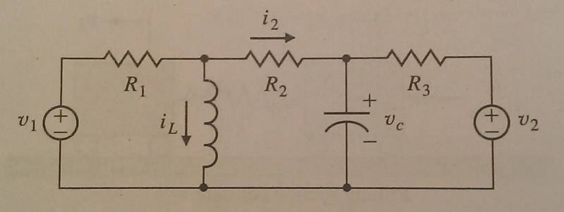

Obtain the state equations in Matrix form for the two-input and one-output circuit shown in the figure below where the output is [itex]i_2[/itex].
Circuit schematic with voltage sources v1 and v2, resistors R1, R2 and R3, an inductor carrying current iL, and a capacitor with voltage vc. Current i2 is marked on the top branch between R2 and the capacitor.
Ohm's Law, KVL, KCL
Hand-drawn circuit schematic with source V1 and resistor R1 on the left, an inductor and a series resistor R2 meeting at nodes a and b, a capacitor with voltage Vc, resistor R3 and source V2 on the right, with mesh currents i1, i2, i3 and branch currents i2 and iL labelled.
Currents i1, i2, i3 assumed clockwise. Is there a better assumption I could have made?
Nodes:
a: ##i_1=i_2+i_\mathrm{L}##
b: ##i_3=i_2+C\frac{\mathrm{d}v_C(t)}{\mathrm{d}t}##
Loops:
l1: ##v_1-\mathrm{R}_1i_1-\mathrm{L}\frac{\mathrm{d}i_1(t)}{\mathrm{d}t}=0##
l2: ##v_C-\mathrm{?}-\mathrm{R}_2i_2=0##
l3: ##v_2-v_C-\mathrm{R}_3i_3=0##
Before I start solving for unknowns, I need a little help writing the loop equations. After that, I'm not sure how to choose my state variables.
-Captain1024
Your first loop equation is incorrect. Notice that the current in the branch with the inductor is ##i_1 - i_2##, so you would instead have ##-L \frac{d}{dt} \left(i_1(t) - i_2(t)\right)##.

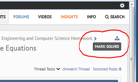

The feature is back. Go to the top of this page and look to the right of the thread title (all the way to the right of the page). Find the black icon:
Screenshot of a forum page showing a red circle drawn around a sitemap-style icon and a 'MARK SOLVED' tooltip beside the thread title.
Just hit that and it marks the thread "Solved".
