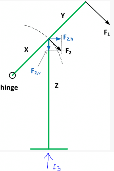

Lever diagram: a green inclined bar pivots at a hinge on the left, with labelled lengths X and Y and an applied force F1 pointing down-right at its far end; a vertical green rod labelled Z drops from the bar to a base where a blue upward arrow labelled f3 acts; blue components F2,h and F2,v with resultant F2 are shown at the junction.
The only unknown I have is the distance you have labelled Y. I have added 'F3' to the diagram to show the force acting against mechanism (representing the resistance of the waste).
How do I find the value of F2? Do I just substitute F2v for F3?

I notice that you now have the applied force acting at right angles to the lever. Would this be likely - as it would tend to tip the bin over. I would think that the natural direction to push would be vertically downward. The bottom line is that the force on the rubbish would be twice the applied force (more accurately [X+Y]/X plus or minus any variation in applied angel and friction). The angle of the bar to the horizontal will have no effect because the ratio of the perpendicular distances is the same.
Apart from any weight force from the press arms, the force on the rubbish is the same as the magnified force from the operator. F2,v = F3)

So the equation above is not relevant as the angle does not need to be considered as the force is worked out using a ratio of X and Y?
For a vertically applied force, you are dealing with similar triangles here. The ratio of lengths of the horizontal sides are the same as the ratio of measurements along the bar.
X and X+Y, actually
