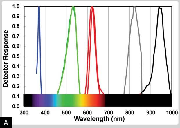

Oftentimes color discrimination is done with filters over ordinary photodiodes
http://www.pixelteq.com/product/pixelsensor/?gclid=CN-mv8nvgcUCFZKGaQodWj0A-Q LED's can be used as light sensors and they're naturally 'frequency' selective...
see if this article has any clues for you
http://makezine.com/projects/make-36-boards/how-to-use-leds-to-detect-light/
Figure A shows the spectral response of 7 blue, green, red, and near-infrared LEDs that replace the usual silicon photodiodes and filters in my modified Multi-Filter Rotating Shadowband Radiometer, used for solar spectroscopy.

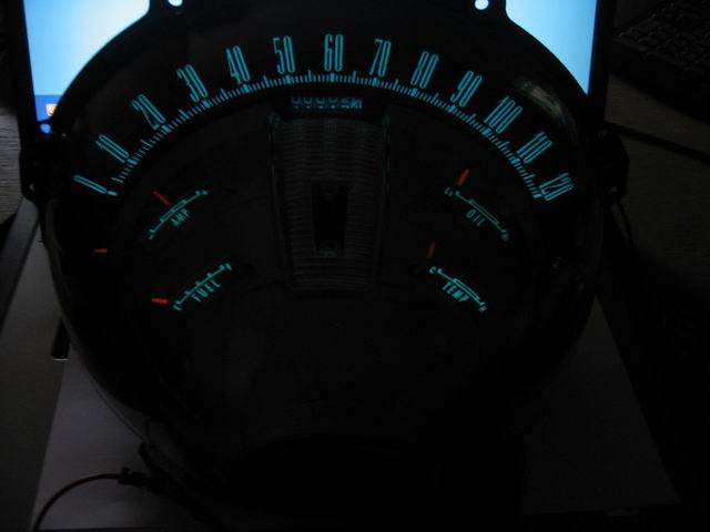

OLED's ? fascinating. My 1962 Chrysler had an electroluminescent dashboard...perhaps precursors to OLED's.
Thanks dlgoff , for introducing me to yet another world all its own..
