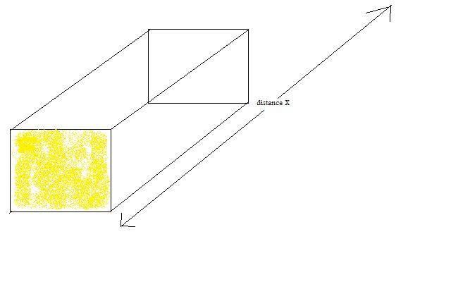

Spray paint is a good example,
Further you pull back the can, less intense the color gets ...because the area is increasing. That seems to be the whole logic. But what happens if you pull back the can & the area doesn't increase?
Like,
Imagine the yellow box a source of radiation. Distance X is farther away, but the same area. So light should have the same intensity? If distance X was 100 kilometers away, I wouldn't think so.
