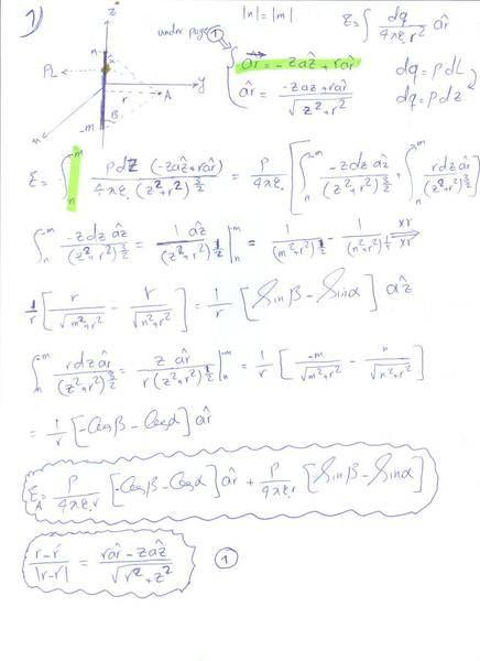

i have some questions about to obtain finite line charge equation.
as you know the equation of a finite line charge equation is
c{P_{0}}{4\pi%20\varepsilon%20r}\{(Cos\alpha%20+Cos\beta)\hat{ar}+(Sin\alpha-Sin\beta)\hat{az}\}.gif
now i want to demonstrate this equation.
at first i assume that charge element on z>0 so
1-

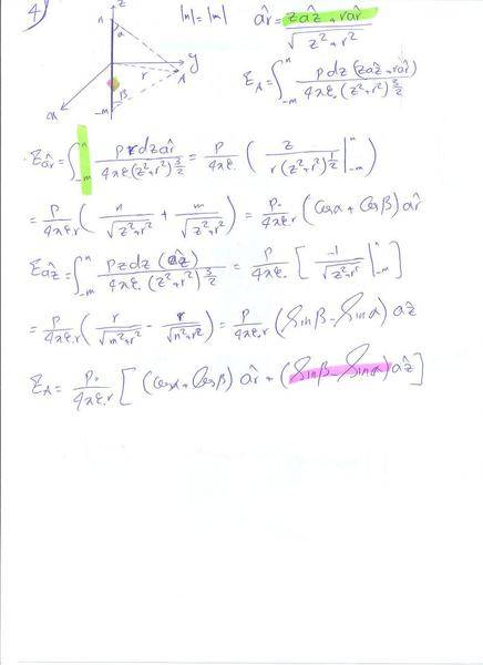

i solve the problem but my final answer is different from the above answer.it seems the integral limitation give me a (-) to statement.so i change it in next step and find the correct answers
2-
as you see that answer is completely correct.

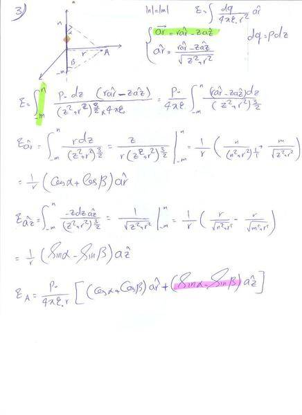

now i assume that charge element is z<0 so i resolve the problem
3-

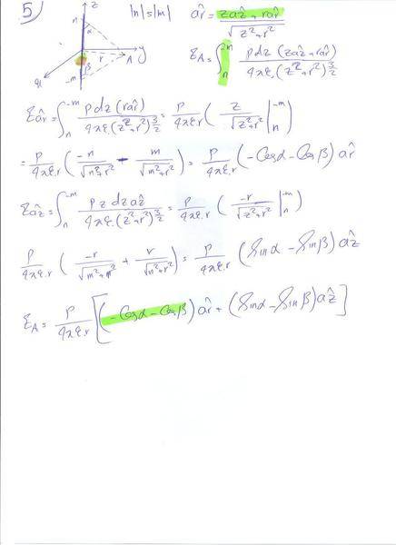

as you see the answer is different from the correct answer so i assume that i get wrong intergal limitation and resolve in next step
4-
again the answer is wrong from correct.
where is my problem?

Hello baby_1.
The charge density ρ is positive. So, the charge dq is also positive. When you write dq = ρ dz you need to make sure dz is positive so that dq will come out positive. To make dz positive, you have to integrate in the direction of smaller to larger z. That is, integrate from –m to n. That is why your second method is correct and your first method gives the wrong overall sign.
When you are considering an element of charge dq located at negative values of z, then the ##\hat{a}_z## component of the field will be positive. But note that the expression ##\frac{-zdz}{\sqrt{z^2+r^2}}\hat{a}_z ## does point in the positive z direction because z is negative. So, you would not want to write ##\frac{+zdz}{\sqrt{z^2+r^2}}\hat{a}_z ## for charge elements with negative z (or positive z) because that would give the wrong direction. You should see that you can use the expression ##\frac{-zdz}{\sqrt{z^2+r^2}}\hat{a}_z ## for the entire integration from –m to n.

If you look at your first picture, it shows the electric field dE from a dq located at positive z (B) and a dE from a dq located at negative z (A). Which of those two electric fields is produced by the charge at negative z? Is the z component of that electric field positive or negative?
