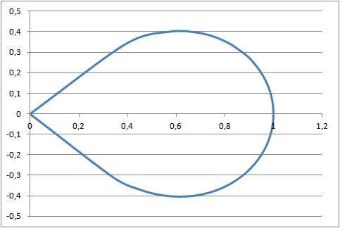

Given the polar curve [itex]r = 3\sqrt{\cos{2\varphi}},\ -\frac{\pi}{4}\leq\varphi\leq\frac{\pi}{4}[/itex]. Find the area of the surface enclosed by the curve using line integral of the second kind.
According to Green's theorem: if [itex]F(x,y)[/itex] and [itex]G(x,y)[/itex] are continuous on a smooth closed graph ([itex]r(\varphi)[/itex] in this case), then [itex]\oint_L F(x,y)\mathrm{d}x + G(x,y)\mathrm{d}y = \iint_D G_x(x,y) - F_y(x,y)\mathrm{d}x\mathrm{d}y[/itex].
The textbook, however, is very ineloquent as to what exactly [itex]F[/itex] and [itex]G[/itex] are and there are no examples given with polar curves. Do I have to parameterize the curve? I don't understand. :wideeyed:

Plot of a closed curve in the xy-plane, symmetric about the x-axis, starting and ending at the origin, with x-axis ticks 0 to 1,2 and y-axis ticks -0,5 to 0,5.
This is the curve. Observe:
  1. x = r*cos(φ), y = r*sin(φ)
  2. sin(-φ) = -sin(φ), so the part above the x-axis is equal to the part below
  3. You do not need any fancy theorems to do this integral.

The area is ##\iint_D 1 \, dx dy##, so you need to devise ##F(x,y), G(x,y)## that satisfy ##G_x - F_y = 1 ## everywhere (or, at least, inside the curve). Can you think of some convenient functions ##F,G## that have that property?

The area of a polar region ##r = f(\theta)## is given by:
$$\frac{1}{2} \int_a^b f^2(\theta) \space d\theta$$
This will allow you to solve the question quite easily as you already have the limits.
On a side note, I think you are referring to the reverse implication of Green's theorem, which allows you to compute areas. Since the area of a region ##D## is given by:
$$\text{Area}(D) = \iint_D \space dA$$
We wish to choose the functions ##P## and ##Q## satisfying Green's theorem such that:
$$\frac{\partial Q}{\partial x} - \frac{\partial P}{\partial y} = 1$$
There are several possibilities for choosing these functions, which all lead to the same result for the area of a region ##D##. Let's choose ##P = -\frac{1}{2}y## and ##Q = \frac{1}{2}x##. The following result can then be deduced directly from Green's theorem:
$$\text{Area}(D) = \frac{1}{2} \oint_C xdy - y dx = \iint_D \space dA$$
If you were to "go backwards" from ##r = f(\theta)## by using polar co-ordinates, you could also use the above result to get the exact same answer, i.e:
$$\text{Area}(D) = \frac{1}{2} \oint_C xdy - y dx = \frac{1}{2} \int_a^b f^2(\theta) \space d\theta = \iint_D \space dA$$
Would the area then be
[tex]A = \int_{ -\frac{\pi}{4}}^{\frac{\pi}{4}} \int_0^{r(\varphi)} r\mathrm{d}r\mathrm{d}\varphi[/tex]
Edit: Yes, it is, thanks, I get it now.
