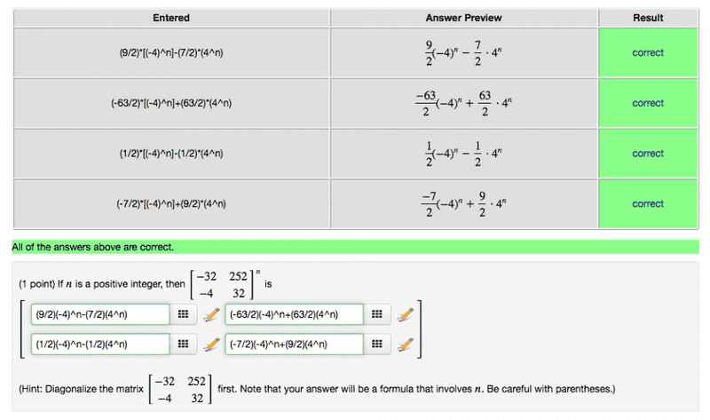

I was able to solve the problem guys, thanks for your help

Alternatively, using the method in #4 we have
[tex]A^n = 4^n E_1 + (-4)^n E_2, \; n= 0,1,2, \ldots ,[/tex]
giving
[tex]I = E_1+E_2\\<br /> A = 4E_1 - 4E_2.[/tex]
Thus
[tex]E_1 = \frac{1}{8}A + \frac{1}{2}I = \pmatrix{-7/2 & 63/2 \\ -1/2 & 9/2}[/tex]
and
[tex]E_2 = -\frac{1}{8} A + \frac{1}{2} I = \pmatrix{9/2 & -63/2 \\ 1/2 & -7/2}[/tex]
