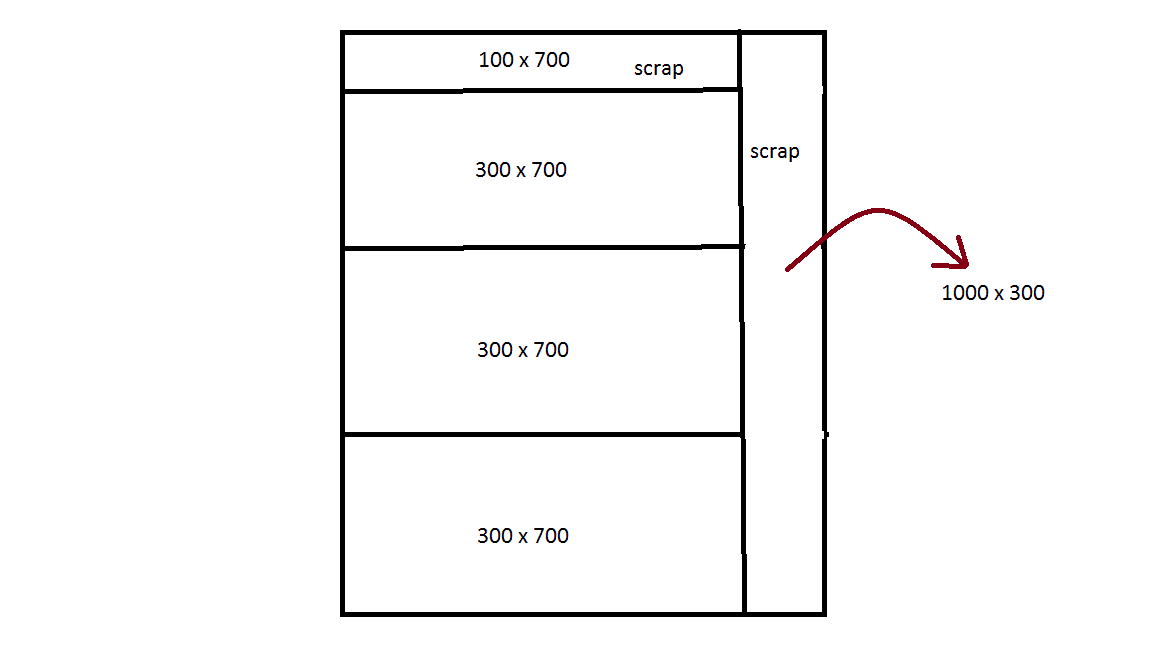

Hmm... that's strange... I get 6 plates of type A with 10% scrap... :confused:
Do you know what is going on? Could it perhaps be that plate A should be 300 x 700 mm? (Wondering)​
When the plate A is 300 x 700mm we get the following:
or not? (Wondering)
Is the scrap now 16% ? (Wondering)
Can't we fit another 300x700 in the scrap at the right of size 300x1000? (Wondering)

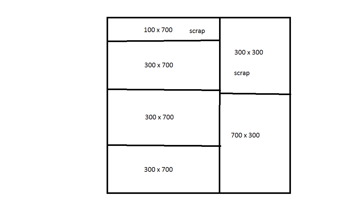

Oh yes. So, it must be:
or not? (Wondering) So we $\frac{100\times 700+300\times 300}{1000\times 1000}=\frac{7\cdot 10^4+9\cdot 10^4}{10^6}=\frac{16\cdot 10^4}{10^6}=\frac{16}{100}$, i.e., $16\%$ scrap. To formulate the problem as a linear programming problem do we use the 7 schemes for the constraints? And for the objective function, since we want to minimize the cost, do we have to use also the information that the costs for the workpieces are proportional to their area? (Wondering)
