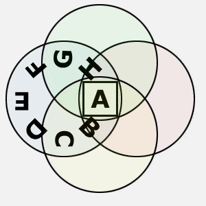

Basically what I'm trying to accomplish is having 4 plastic circular platters or turn tables if you will (very thin and about 6 inches in diameter) rotate behind a small window. Around the brim of these platters will be cutouts of different images or symbols. The stepper motor will rotate the platters, thus showing a different symbol through the window...much like a slot machine would but they rotate around the z-axis rather than the x-axis.
The accuracy doesn't have to be exact, just enough so that one symbol can line up inside the window. I've read that the stepper motor's error % is not cumulative to each step possibly making this feasible?
The cheapness of the motor comes by the fact that I need to move 4 platters, but maybe if I get frisky with it I can rig it so that 1 motor can control all 4? But i'd like to just get one working right now.
Is this the basic idea?
You got it...am I in over my head or is this fairly simple?

The per-step error of stepper motors is not cumulative, but if they miss a step they will become out of sync with the software controlling them. This is also a problem if they get moved or if things gets shut down in an unknown state. You could notch or mark the disk and use an IR LED/phototransistor pair to determine the orientation, or provide some way to adjust the disk positions to reset them to a zero position. Servos will not have this problem, you can tell them to go to an absolute position and they will do so.
Servos are more expensive, but stepper motors will require more drive electronics, and more work overall...specialized driver chips, or microcontrollers with sufficient output pins and power transistors/H-bridges, and possibly some kind of feedback. Your desired price per motor makes me suspect either option will cost more than you want to spend.
Driving multiple disks from one servo/stepper/gearmotor/whatever will add a great deal of mechanical complexity. Unless you're well equipped to design and fabricate whatever custom mechanical parts you need, I would not recommend it.
