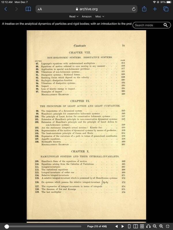

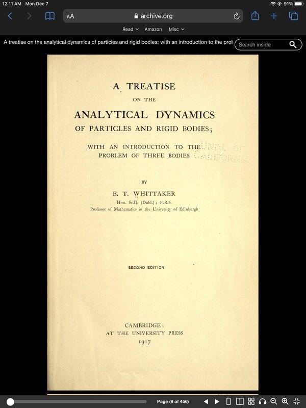

Whittaker has a chapter. See attached.
Thank you for posting. It’s funny that they should mention curvature of a surface. I always thought that
rolling without slipping on a surface with constant curvature = holonomic
and
rolling without slipping on a surface with non-constant curvature = non-holonomic
So at first glance it seems like Whitaker corroborates my notions.
I’ll check it out. Thank you again.

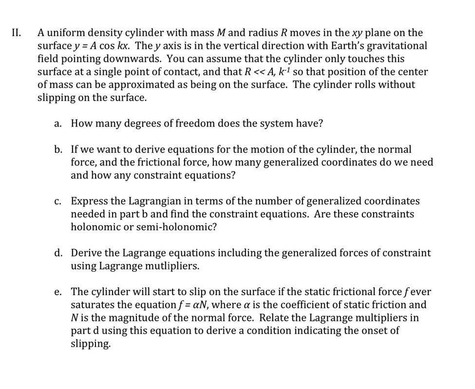

One of my grad classical mechanics test questions (in 2017) was the following
Typed exam problem II about a uniform cylinder of mass M and radius R rolling without slipping on the curve y = A cos kx, with parts a through e asking about degrees of freedom, generalized coordinates, constraints, Lagrange equations and the onset of slipping.
The constraints I come up with are
##f \left(x,y\right) = y - A\cos \left( k x \right) = 0####g\left( \dot{x} , \dot{y} , \dot{\theta} \right) = \sqrt{\dot{x}^2 + \dot{y}^2} - R \dot{\theta} = 0##
The first being holonomic and the second being non-holonomic. I believe the second constraint must be put into the form of ##g\left( \dot{x} , \dot{y} , \dot{\theta} \right) ## in order to answer part e)
For what it's worth I know that my professor did not use this question in later semesters.
If you mean that the problems sheet you brought contains nonholonomic problems that is wrong.
Isn’t rolling without slipping on a surface of non-constant curvature a non-holonomic constraint?
I believe in order to solve for the force of constraint in part e) you need to cast the second constraint as a non-holonomic constraint (i.e. a purely velocity constraint?)
##g\left( \dot{x} , \dot{y} , \dot{\theta} \right) = \sqrt{\dot{x}^2 + \dot{y}^2} - R \dot{\theta} = 0##The constraint may be linear in overall velocity
##v = \sqrt{\dot{x}^2 + \dot{y}^2}##
But it's not linear in ##\dot{x}## or ##\dot{y}## (Which again I think we have to keep ##\dot{x}## and ##\dot{y}## separate in order to solve for the force of constraint).
Unless there is a way to "linearize" this constraint that I don't know of.
If a cylinder rolls on the floor of the form y=f(x) then the center of the cylinder describes a curve y=g(x). This is under assumption that the radius of the cylinder is smaller than 1/curvature of the floor. The function g is determined by f.
If the cylinder can slip then this is a system with two degrees of freedom. Generalized coordinates are the angle of cylinder's rotation and x-coordinate of the center of the cylinder. These two coordinates as well as corresponding generalized velocities are independent. The system is holonomic.
