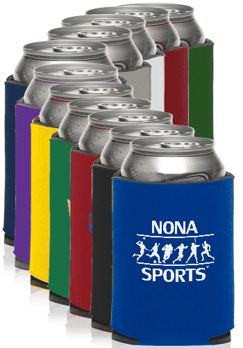

Is neoprene environmentally friendly enough? :smile:
https://www.discountmugs.com/product-images/detail/premium-4mm-collapsible-can-coolers-kzepu.png
Ah, this is quite interesting. I'm going to look into a further. Thank you!
