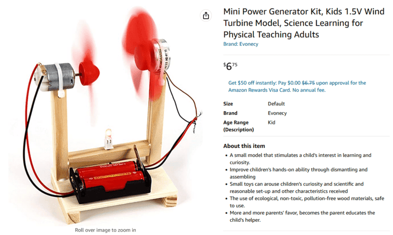

Have you considered a wind turbine kit? Here is one for the price of a hamburger which the kids can probably assemble under your guidance. Other options are available, of course.
Is that one of those new-fangled ones that run forever on one set of start-up batteries?
  • Haha
I don't think that this is a putative (dare I say it?) perpetual motion machine. It looks like the fan on the left is connected only to the LED between the fans.
