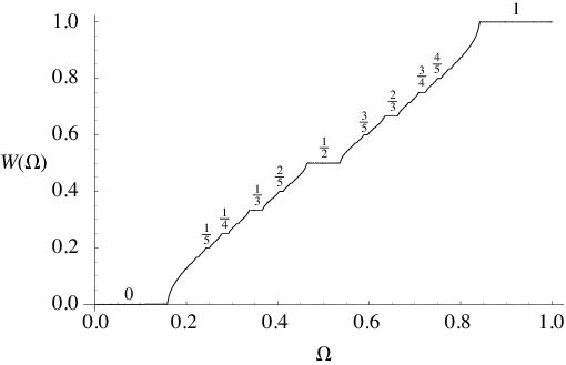

One example would be a random variable with the devil's staircase (or Cantor's function) as a distribution function. For a description see:
http://en.wikipedia.org/wiki/Cantor_function"
It's a continuous function, differentiable almost everywhere, with a null derivative (almost everywhere). Therefore, it doesn't have a pdf, not even in a generalized sense.

That would be the "Devil's staircase"? I recall it from Real Analysis some time back as an exotic example of a continuous function useful for many counter examples.
Edit: Here's its pic on Wolfram Math:
