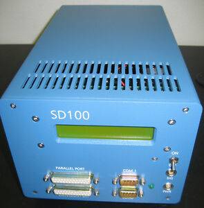

Does anyone have any information pdf manuals etc. on the Verity SD100 Monochromator? Even first hand experience operating this unit would be helpful! I have combed through the internet to no avail, sent more than several emails to the manufacturers with no replies(not sure if the company is defunct).
I understand this unit was manufactured in 1998 but is pretty sophisticated for the time as it is microprocessor controlled etc. I have been trying to sniff the output on the serial connector on the unit but nothing comes up. It powers up goes through a self check and does an grating scan as you can hear the stepper motor inside moving etc.
I am hoping to be able to retrieve information on the serial output to use for a spectral bandwidth analysis and observation etc. any information even operational hands on would clue me in this unit as it is really a nicely built and quality looking boat anchor which i would hate to go fishing with. Thanks for any inputs on this question!

Does that COM 1 port look like just a printer output port, or does it look like a bi-directional control port? It's hard to tell from the picture, but is it a male DB-9 connector? Have you tried measuring the voltages on the pins in that connector? What-all have you tried for connecting to it to see if you can get some response? It may require a null modem cable to be able to communicate with that port.
You could try various BAUD rates and handshakes, and try using the pretty universal query "IDN?" to see if you get a response. It may also output some ID string when the unit is powered up...
Yes Berkeman the COM1 port is a DB-9 Connector etc. I attached a serial adapter to my Computer to determine what is coming and going and I have tried changing the baud rates etc and other connections to if anything shakes out of the unit. I have not tried the IDN query but will try in a few minutes to see anything as well. I think you might be right about the ID string etc. I will check back to and let you know what i find.

So i wrung out the pins of the Serial 9 pin here is what was measured from the signal ground pin. The only pin that showed voltage of anything was the pin 3( I think RxD) which was roughly 10v from the pin 5 signal ground. I tried various combinations with the Putty program to check and see the serial signals etc. nothing was working so far. Maybe i don't have something connected up right? Not sure since this is my First in digging in to the nuts and bolts of serial connections etc. I am all ears to any other suggestions!!!

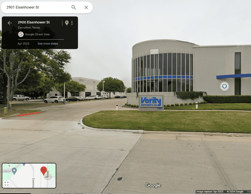

Hmm, the latest press release on their website is from 2016, but at least Google Maps seems to show them still there early in 2023:
Great Investigative work!!!!

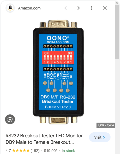

Berkeman, I just ordered one of those RS232 Breakout Led monitor units I will check and see what I get when it arrives etc. I will be traveling til the end of the month so I may not get to test and see what I am getting til the beginning of next month. I really appreciate what you have suggested on my investigation of this unit. Lets please keep this conversation going when I get back next month. Cheers!!!
George
I finally got back to use the RS232 Breakout led monitor. What I observed is the only light that came on at first power on was green which flickered to red on the Txd led and stayed red until the self check was complete. No other leds were observed to come on. I suspect that the Txd led is waiting for a signal? perhaps there maybe a problem on the interface board!? Not sure what are your thoughts on this? Meanwhile I am contemplating opening up the unit and looking at the chipsets etc to try and determine how it might be controlled etc through this port.
When you use PuTTY or similar terminal emulator program to try to send commands to the peripheral, what do you see? Have you tried using a Null Modem cable or adapter yet?
Yes I used the PuTTY software and hit keys randomly and notice the lights on the Txd flickering especially when I change the baud rate down to 900 etc. Xon Xoff is selected with raw data set etc. Nothing happened on the other lights etc.
