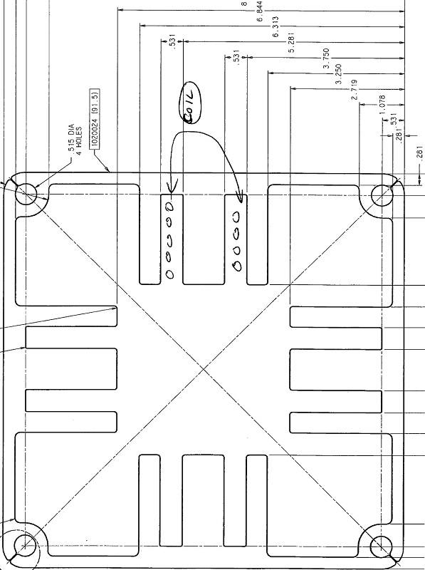

Take a look at US Patent 6,389,941. The electromagnets in that patent were designed for 1600 lbs force at 50 amps through a 1/8" air gap. It needed about 170 peak volts to get the 50 amps at the desired frequencies. My hazy recollection is that we used 0.015" thick motor lamination steel from Tempel Steel. The steel thickness was selected to meet the frequency requirement of approximately 55 Hz. We bought the steel in rolls, and cut the laminations on a laser cutter. Four stacks, each 4" thick, per machine tied up the laser cutter for some time.
The design calculations could easily have been done with pencil and paper, but were done in a spreadsheet in order to save them on the company network. Good search terms to get started: Electromagnet calculations. The drawing below is from the invention disclosure:
And be advised that the US Patent Office has a special program for small entities. It's called a provisional patent application. The filing fee used to be $65.00, it gives you one year to file a full patent application. During that year, you are allowed to use the term "patent pending", and to show or sell the idea to anybody. Details on their web site: https://www.uspto.gov/
That is in no way like what I am making. One year would be ok but I think I will need more time. I also may not be selling them. Right now there are 10 to 15 companies that do anything that would like it. This will do it at 1% of the cost.
