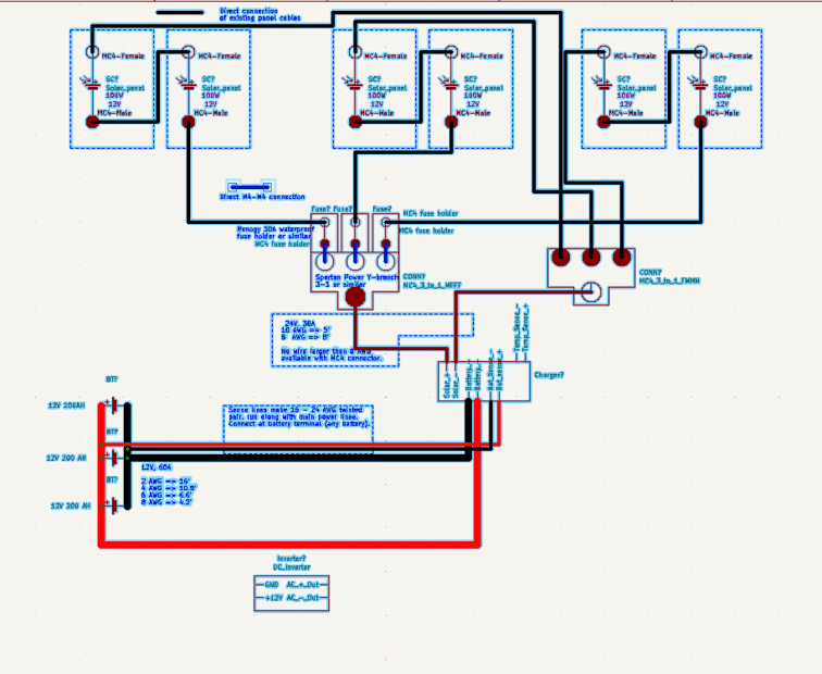

I will define system level components with a small number of I/O's for a solar power system, panels, junction boxes, batteries, charger, inverter, etc, I will put all of the user visible connections on them, and I will create a schematic that can also serve as a hookup diagram as I will place multiple components that serve as a single electrical node and show them shorted (eg I will have three batteries in parallel on the schematic instead of only a single 12V supply component). I would like to print this to a variable size pdf file, probably larger than I have the ability to print on a single page without scaling down. Orcad, if I still had it, would work fine for this.

I started out with Eagle and I ran into limitations on achieving communication clarity with my schematic - I have some drawing complaints. Perhaps ironic given my statements about PP being cumbersome. Specifically, there is no way to make different nets different colors, the database is layer-driven, even for the schematic capture tool, and all objects on a given layer will have that layers color. Nets is one of the system defined layers, and all net connections go on that layer. I can change the color of the nets layer, but all nets follow that color.
I gave KiCAD a try and its schematic capture is not layer-based, I can modify the color / style / weight of each net connector individually, so I am much more able to make my schematic serve the purpose of a hookup diagram. I will finish the project in KiCAD.
Interesting, I don't think I've ever seen that, and it would just confuse me most likely. But I'm used to schematics (sometimes with more drawings-ish at the top hierarchical block level). What kind of drawings use different colors for interconnection nets/busses/whatever? Can you link to some example drawings? Thanks.
Wiring schematic of a solar array: six solar panels with MC4 connectors feeding fuse holders, a Y-branch combiner, a charge controller, and a battery bank with an inverter, annotated with cable gauge and length notes.
Along with the notes, I am using the different colors to describe the specific connectivity between the system components.
Edit:
I see its not very readable. In case anyone wonders what I mean by 'describe the specific connectivity', for instance:
The top black lines indicate MC-4 connector cables that come with the solar panels themselves (Not sure on these cables AWG / length, may need to modify this). The short blue stubs are where in-line fuses plug into MC-4 connectors directly. The maroon lines are relatively lower current cables with the length vs AWG restrictions in the notes. The heavier red/black lines at the bottom are high-current cables with different length restrictions noted, and the narrower adjacent red/black lines are sense lines with some instructions for how they need to be run. Hmmm. I have the panels connected reverse polarity, good thing the picture is not too readable. :-p
Fair enough. I just did a Google Images search for the wiring diagram of my YZF-R1, and it had colors all over the place. It's B/W in my hard copy Service Manual, but has multiple colors in the web images.
