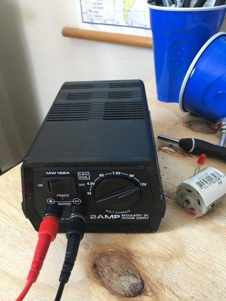

I have a 2 AMP regulated DC power supply, with variable voltage 3 - 12 v. If in a small circuit, i.e, small copper wire with 1 ohm resistor. Why am i not getting at max Amps?
What does your power supply look like? Doesn't it have its own resistance? Have you considered that?
Aside from that, what size copper wire are you using and what is its resistance?
I suggest you draw out a sketch of your circuit and the values of each resistance along with the voltage setting. What do your calculations show for the current when the voltage is 12 V?

I attached a pic of the PSU..
I have done some calculations assuming (generously and for simplicity, i think) that the wire has .3ohms. So at 3V, shouldn't i be getting 10 A?
I understand there may be "short-circuit" prevention elements in this PSU. Is this what you're talking about?This could be exactly the problem right? Other than that, I have measured the V across the PSU outputs at each of the Voltage levels. Each one is accurate to .05 V. Therefore, i think, internal resistance of the PSU can be taken out of the equation.
Not with that power supply. It's output is rated at 2A max. Try putting 12V across a 6 Ohm power resistor. How much power will that be? (Be sure to use high enough wattage resistor to not smoke the resistor).

As Berkeman said, no it won't supply more current that it's designed to ... in this case 2A max
Yes

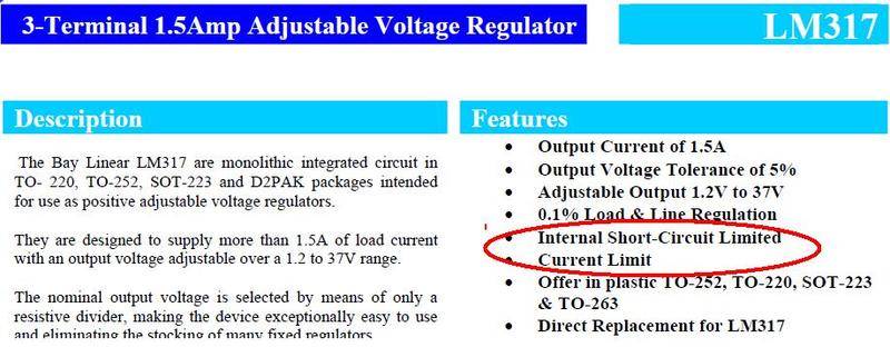

It says it's a regulated PSU. The overcurrent protection will be either be 1) part of that normal protection in the regulator chip
or 2) will be made up of discrete components
just as an example of a voltage regulator chip ... note the two comments I have circled
Dave
