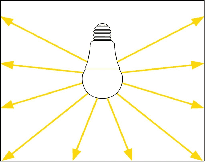

How to calculate lux here ? And what are Lumens, when I have 800 Lumen Light bulb does it mean that in everydirection I have 800 Lumens ?
Hello !
I've got a problem understanding what are Lumens and how do I look at lux as well.
For example here :

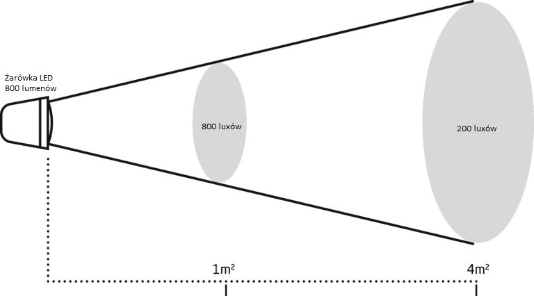

It makes 800 Lumens in 1 m^2. Does it mean that in every direction in 1m^2 there are 800 Lumens ?

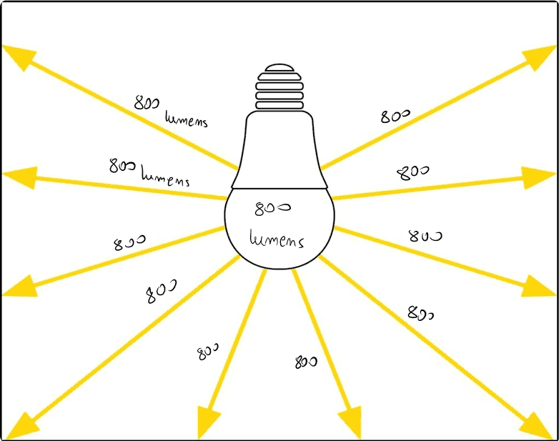

Or when I have a light bult with 800 lumens :
Those 800 Lumens in light bult means that all those arrows in this picteres are 800 Lumens ?

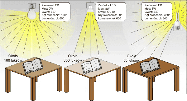

Also how do I calculate lux in those pictures :
All I know is that all of them are 600 Lumens or 640 Lumens but some of them have 100 Lux or 300 Lux, in the picture Lux = Luks.
How does it work ? I know the definition but I don't really understand. Can someone tell me more in simple words ?

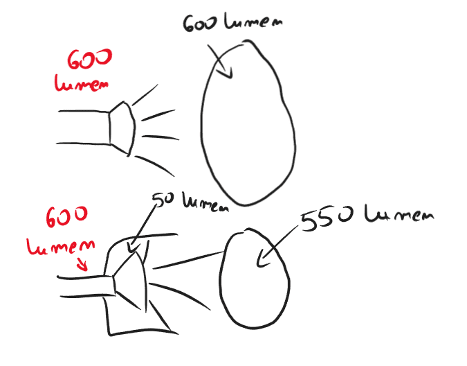

I'm not that bright at physics so is it something like that ?
800 lumens in every direction ? Or is it divided ? if so
then why here it's 800 lumens

It's not an easy subject for me because it creates a lot of misundestanding in my head. Like intensity, where the light is 800 lumen or something like that.
The only thing I know is that lux = Lumen/m^2.
Lumens are a measure of total light output the source per unit of time.
Lux is lumens per square meter.
So, in the picture of the light bulb, the total output of the bulb is measured in lumens, while the lux is the total lumens/ m^2
So, let's say the total surface of the bulb is 0.01 square meter, then the lux at the surface is 80000 lux.
If we enclose the bulb in a 1 meter radius shell, the total light striking its interior side is still 800 lumens, but the lux (since the lumens are spread out over a larger area) drops to 63.66 lux

So I can have more lux than lumens like for example 800 lumens and 80000 lux. The surface still has 800 lumens but it's much tighter ? The same goes with larger area, the area still has 800 lumens but it is spread all over.
I thought that total brightness of the light is lumen not lux. So 80000 lux is really bright. I thought that 800 Lumens is a total brightness of a light. Or maybe I am wrong ?
So may I ask that. My picture with a bulb and arrows around it means that I have 800 lumens but every single one of this arrow is like 1 lumen or lower ? Or how does it work with single arrow in the picture?

But how should I look at those arrows here ?
They have lumens or not ?
Also when I have a light bulb without a lampshade like here :
the lux is equal 100 lux.
But when I add lamp shade :
It increases to 300 lux. But some light is "hitting" lampshade. So why is it 300 lux ? Lampshade is also a
surface. Part of light at the surface and part at the table. But here 300 lux is just how 800 lumens are distributed. But some of this 800 lumens are distributed on the lampshade so I don't know ...
No! Not! 800 lumens is the total amount of light given off by the bulb.
Suppose you have a garden-sprayer that gives out a total of 2 litres of water per seond. If the spray-head actually produces 1000 very thin streams, does it make sense to label each of the very thin streams '2 litres/second'?
The '100lux' and '300lux' refer to how well the table is lit.
Without the lampshade, a lot of the light misses the table. But when the lampshade is added, it reflects this light onto the table. The table receives extra light because of the lampshade. This make the illuminance of the table increase from to 100lux to 300lux. The table is lighter (though other parts of the room will be darker).

Okey so the arrows are like part of the lumens. Just an example 800 lumens is total so like 1 arrow is like 1 lumen. It's just an example in real life it could be smaller maybe even a lot.
The table ?
Isn't it referring to the whole room ?
Same goes here :
It's 200 lux but it's not the part of this light but the whole light.
The table is just the part.

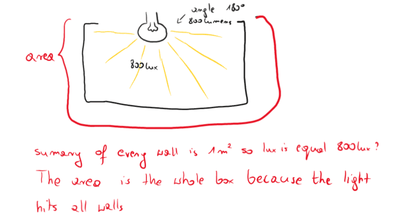

And one more thing. If I want to have for example 800 lux the light bulb on the first picture :
I have to make a box that sum of all walls is equal 1m^2 ? And how about distance ? Is it also important in that box 1m^2 ?
How many arrows should you draw: 6, 10, 100, 70,000? What about the gaps between the arrows? Labelling arrows with a number of lumens doesn't really mean anything and could be misleading. I would advise against it.
Xenon02 said:
The table ?
As shown in the 3rd diagram in Post #1
No. The illuminance (in lux) of any area depends on how far the area is from the lamp. The values of 100lux and 300lux must refer to some specific region; here it is the table-top.
Xenon02 said:
Same goes here :
The lamp produces 800 lumen as a beam of light. The beam widens as you get further from the lamp.
In the part of the beam with area 1m², the light is spread across 1m², so the illuminance at this part of the beam is 800lumens/1m² = 800lux.
In the part of the beam with area 4m², the light is spread across 4m²,the illuminance at this part of the beam is 800lumens/4m² = 200lux.
Outside the beam, the illuminance is zero.
The 'first picture' (in Post #1) shows an 800 lumen bulb and this is different to the diagram you refer to. So I can't tell what you mean. The shape of the box would depend very much on the distribution of light from the bulb. Draw a diagram showing your solution and we can comment on it.

Xenon02 said:
So ok the lamp has 300 lux.
No. A lamp doesn't have a 'lux value'. A lamp's total light output is measured in lumens.
When the light from the lamp then reaches a region with a certain area, the amount of light per unit area is then measured in lux.

I was also just curious just how the lumens and lux works when the light isn't just a circle but it is spread on the walls because light has 180 degrees or even more. Simple ones like flashlight have less than 90 degrees so it is easier.
I have seen this flash light with 200 lux and 800 lux. So I was wondering if I could do the same with a light bulb that his range is 180 degrees like here :
And the whole area he is lighting is 800 lux. Not the table but the whole area he is providing the light.
I mean here this equation 800 lux = 800 lumen/1m^2.
So if this light is giving light to walls and floor it is not a simple beam that has a shape of a circle so maybe if the floor and wall were summary of 1m^2 then the whole area he is giving the light would be 800 lux.
Its not really an angle in degrees beause we are working in three dimensions, not a simple (2D) plane. We have to use 'solid ang;les' which are usually measured in units called steradians. This starts to make the maths a bit more omplicated.
If you are interested, look up 'solid angle'.
A flash light should not be rated in lux. I suppose you could use lux if you also gave a reference distance and area. E.g. you could rate a a flash light as '200lux at 10m over 0.8m^2'. This would mean that, when shone at a wall 10m away, the flashlight lights up a 0.8m² area of wall with an illuminance of 200lux.
It's more complicated.
1) Different parts of the room are at different distances from the bulb; e.g. the bottom corners of the room are further from the lamp than the floor below the lamp. Illuminance (in lux) depends on the distance.
2) The light given off by the lamp may be stronger in some directions than others (e.g. downwards stronger than sidewards); bulbs seldom produce 'evenly spread' light.
These sorts of problem can be dealt with, but quite a lot of maths is involved to do it accurately. A lighting engineer would typically use some ‘rules of thumb’ rather than accurate calculations.

May I also ask you that when I use lampshade, and the lightbulb has for example 600 lumens. Theoretically the light should be reflected from the lampshades so that the lightbulb is illuminating on the area is still 600 lumens. But in reality some light still illuminates the lampshades not everything is reflected right ? So the lightbulb that has 600 lumens now has a beam that can maximally provide for example 550 lumens because some of them are already illuminating lampshade right ?
Like here :
On the red lightbult lumens.
On the black distributed lumens.
1st one doesn't have lampshade and the 2nd one has one. So I thought that some light is reflected and some is not so I thought that the lumen is reduced. Because not all light is received by the area it is illuminating, some of it is on the lampshade.
If something I said isn't understandable please let me know. I'll try to rewrite.

A flashlight produces a cone-shaped beam of light. The angle (actually solid angle) of the cone is important. It the light then shines squarely on a wall, we get a disc ('simple circle') of light.
Xenon02 said:
But for the lightbulb that has 180 degrees which is not just a simple circle
The lightbulb produces a hemisphere of light. (This is a solid angle which we call '2π steradians'.) If the light shines on a wall, the whole wall is illuminated.
However the centre of the wall is a lot nearer to the bulb than the edges of the wall. The centre of the wall will have more lux than the edges of the wall.
Xenon02 said:
Then how close should the wall be to each other to make the whole surface (floor and the side walls) that I can use maximum of lumens which is 600 Lumens and 1m^2. then there would be 600 luxes.
The question is wrong. You can't just ask how to make the illuminance of the walls 600lux. Is that 600 lux at the centre of the wall? Or at the edges? Or some sort of average? See above.
Xenon02 said:
Like this equation 600 Lux = 600 lumens/1m^2 for this 180 degrees light bulb. Without using reflective material, just shortening the distance of the light bulb and the walls + floor.
Or is it more complicated than with the flashlight ?
Yes - it is more complicated because different parts of the wall are different distances from the bulb as explained above.
Xenon02 said:
Of course I just saying theoretically that the light is evenly spread (let's just assume that) and the distance Light bulb - walls + floors are equal.
No. You can't say these things are equal. It makes no sense. Different parts of the wall are different distances from the bulb. You can never get evenly spread light on flat walls.
Ok. Some of the light hitting the lampshade will be absorbed - it gets permanently removed by the lampshade.
No sure I understand. The lampshade does two things - it absorbs some of the light and it redirects (reflects) some of the light. You must take both of these into account.

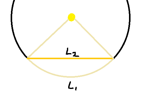

If you take a piece from the sphere with a certain area - that piece is curved.
So when you compare that area with the area projected on a flat surface, you have to be careful.
Consider the analogy with a circle segment and a straight line
##L_1 \neq L_2##
But the larger the radius, the better the approximation ##L_1 \approx L_2## becomes.

1. if there is some amount of lux in a certain area like 300 lux on a table it doesn't mean there is full 800 lumens of lightbulb in this area. It can be part of it like 192 lumens.
2. In a flashlight when I have 200 lux on the 4 m^2 wall contains 800 lumens of flashlight because the whole light is focused in that 4m^2 area so that's why there is 800 lumens and not part of it like in the table example.
3. If I want to have 800 lux using full 800 lumens from lightbulb in a room might be quite difficult to calculate because the light isn't cone-shaped beam like in the flashlight. So it is not focused in one place this light.
4. Shadelamp might receive some of this light from the lightbulb like 20 lumens out of 600 lumens but the rest is focused like the cone-shaped beam so I can use the rest which was 600-20 = 580 lumens and calculate the lux on a specific area using full 580 lumens for example Lux = 580lumens/2m^2 = 240 lux.
Yes.
Yes.
Yes. It's not just a difficult calculation. It's difficult to achieve in reality. (For example, a lighting-engineer might use many lamps and diffusers to achieve an approximately uniform light distribution.)

Ah yes can I ask one more thing ?
For a flash light it's easy to calculate lux because it's a simple equation. Lux = max Lumens/ m^2.
For a light bulb that has this wide range like in the picture with 180 degrees. If I use max Lumens from this lightbulb then I can't use this simple equation to calculate lux which is Lux = max Lumens/ m^2 right ? This equation works only for cone-shaped beam and for a certain area like this table. But for wide range of light this equation doesn't work to calculate lux yea ?
You need some additional mathematics. You can’t use degrees. You have to learn to use ‘solid angles’ (measured in units of steradians) because the light spreads out in three dimensions.
It isn’t practical to explain here. I suggest doing some background reading/viewing. E.g. a YouTube search gives this:
Edit: in the video, the presenter gives solid angle the symbol dΩ. But he should really use just Ω.
I know I should use solid angles but I didn't know how to change this 180 degrees from the picture so I had to use this as my reference. I know it is not correct. I just wanted to show which light did I mean.
I wanted to know that calculating the lux from this type of light with wide range and not a cone shaped beam or a simple plain like table, that it would be more complicated than just Lux = Lumens/m^2. Because it is not a simple plain it is a three dimension and not a two dimension like a simple table or a beam that is a cone shaped beam. But I wanted to know that If I want to calculate the lux using max Lumens from this light bulb with this wide range then this equation Lux = max Lumens/ m^2 wouldn't work yes ? It requires more complex calculation to calculate the lux in a room using maximum value of Lumens with a light bulb with wide range.
Yes - more complex calculations are needed .
You have to learn, understand and use the relevant mathematics, e.g. solid angles, area of a sphere, inverse square law.
As I thought. This simple equation Lux = Max Lumens/ m^2 wouldn't work for wide light beams.
So this equation Lux = Lumens/m^2. Is for specific area (table, wall, object) or if I want to use max Lumens for example flash light then I can use Lux = Max Lumens/m^2. But this doesn't work for wide light beams.
It can work if you only want an average lux value.
E.g. a light bulb in an emppty room emits 100 lumens downwards.
The walls and floor have a total area of 200m².
Some light goes on the walls and some goes on the floor. No light from the bulb goes directly onto the ceiling. (We will ignore reflections.)
The average illuminance of the walls and floor = 100 lumens/200m² = 0.5lux.
However - this is an average. For example the walls could be dim and the floor bright in the middle and dim at the edges. We found the average but it is not usefu herel.
Steve4Physics said:
Not quite:
1) You have the wrong units. The unit for area is m², not m. In an examination, you lose 1 mark!
2) It is not usually a good idea to round intermediate values too much. I would have used A=0.1963m².
For the first one I completely forgot to add ^2. For the second one, I thought I coudl use round it to 0,2 m2
Steve4Physics said:
100lumen /0.1963m² = 509 lux = 510 lux (rounded to 2 significant figures)
You need to be more careful.
Sorry.
And I thought that I can't use this equation for wide light beam. Because I thought it would be more complex. But here the thing I had to do is add up all the surface areas (I mean here floor : 80 m^2 + 1st wall : 40m^2 + ...). I thought that this equation can be used only for for light that falls perpendicularly on some surface, and it was easy for flash light, but the wide light beam they go in many diretion.
So for the flashlight those luxes are also average amount as I know.
In your example with torch where you calculated 50 lux for 5m2. Some square meters receives more and some less luxes. For flash lights it works the same as I know. I thought that it is more of an exact number. Many sites didn't mention this is average amount.
Great thread and why pf is so good. This particular problem raised its ugly head in a problem for me at work. I am going to read this from the beginning to the end as my misconceptions were @Xenon02 also.
So I wasn't alone here :D Good to know because it was a very interesting topic for me.
Yes. At an introductory teaching level, the lux values are usually average ones; and this is not usually made clear.
But in the real world, the average lux value for a large area is often not useful. However, for fun, here a short problem...
The square floor of a room measures 4m x 4m.
A 300 lumen bulb hangs 2m above the centre of the floor.
The bulb emits light equally in all directions.
What is the average illuminance (lux) of the floor?
(There is a simple answer because of the values I’ve used.)
And, if you are interested, the lux-level at the centre of the floor will be more than three times bigger than the lux level near a corner of the floor. So knowing the average value is of limited use.
Having made much of my fabulous wealth by designing precison LED based measurement devices, it may be some solace to @Xenon02 that I always kept a "cheat sheet" of the various photometric and radiometric quantities and their definition (and associated units) on the wall next to me in my office. And I still get it wrong occasionally...
