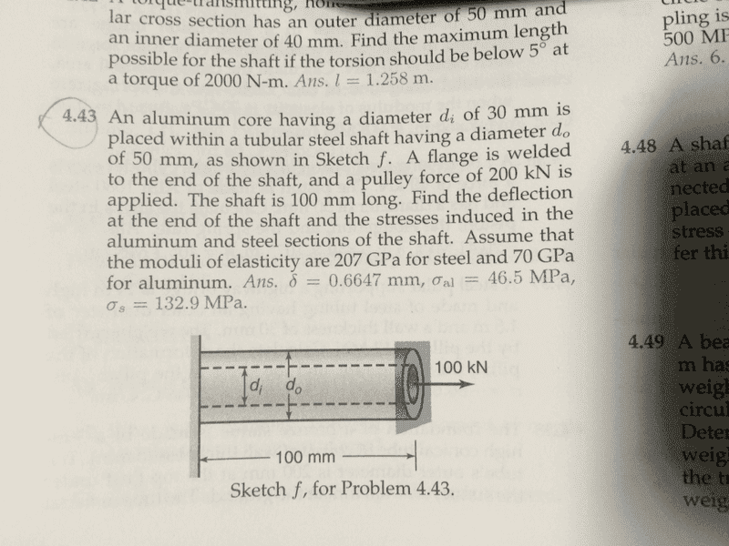

Sketch f: a tubular shaft with an inner aluminum core labelled di and outer diameter labelled do, length 100 mm, a flange at the right end with a 100 kN force arrow pointing right, the left end fixed.
δ = Pl/AE
σ = P/A
I had calculated the deformation for both the steel and aluminum, and added them together to give me δ = 0.481 mm, which is incorrect. I also thought I could simply plug in the force P = 200kN and the respective cross sectional areas for each material into the stress formula, which also gave me incorrect answers. Not sure where to go from here.
Not sure why you would do that. The steel and the aluminum pieces are not in series. Each of the pieces must stretch the same amount, since there is a flange welded to one end and a tensile force is then applied to the assembly.
I also thought I could simply plug in the force P = 200kN and the respective cross sectional areas for each material into the stress formula, which also gave me incorrect answers. Not sure where to go from here.View attachment 95263
Instead of two stiff springs in series, why don't you think of this assembly as two stiff springs in parallel? What's the spring constant for two springs of different spring constants in parallel?
