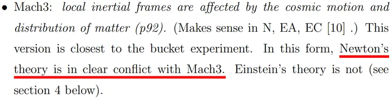

Nope. Your Bondi & Samuel reference enumerates 10 versions of Mach's principle (some of which are contradictory!) and discusses their applicability to the theories of Newtonian absolute space (N) and Einstein in asymptotically-flat (EA) and cosmological (EC) universes. Their "Mach3" is most relevant to the rotating "bucket experiment":
So based on Mach3, your statement that "rotation is absolute, which is my conclusion (Newton's statement)" is simply wrong.
Mach3 states: "The local inertial frame is completely determined by the matter distribution of the universe."
This is precisely what my argument challenges. With ##G \to 0##, there is no mechanism by which the matter distribution can influence the local inertial frame; yet the centrifugal effect persists unchanged. The water is on the walls regardless of ##G## (using closed barrels instead of buckets).
If the inertial frame were "completely determined" by the matter distribution (Mach3), then removing the coupling (##G \to 0##) should eliminate inertial effects. It doesn't. Therefore Mach3 is falsified by this thought experiment.
As for "rotation is absolute" being "simply wrong", could you clarify what determines the local inertial frame in the ##G \to 0## limit, if not the fact that rotation can always be detected locally?
