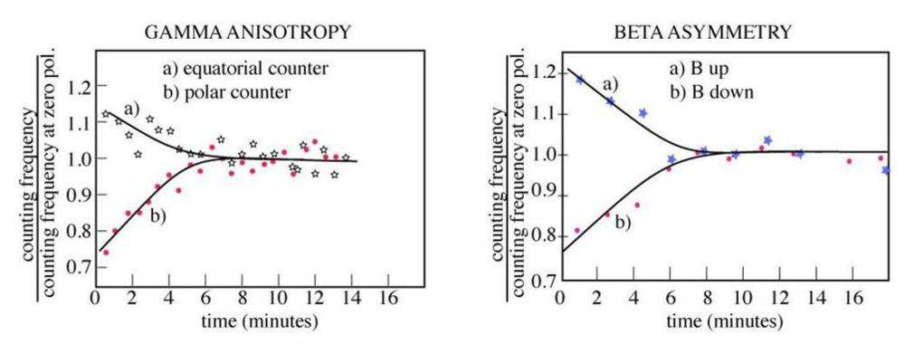

From the attached graphs it seems there is a contradiction. Let's consider the graph about the beta asymmetry and the situation "B up" (a).
If the field is upward, the spin is upward. Since V-A structure implies the emission of the electrons opposite to the spin, I would expect to count less frequently than the situation in which the filed in downward (remember that in Wu experiment the scintillator is over the source). But the graph shows the opposite.
Where does my reasoning fail?

I'm not sure where you got these graphs from because the publication has it in the opposite direction, and it is quite clear:
The sign of the asymmetry coefficient, ##\alpha##, is negative, that is, the emission of beta particles is more favored in the direction opposite to that of the nuclear spin.
Those graphs are taken from "Introduction to Elementary Particle Physics", A. Bettini. Thank you for your prompt reply, it seems there's an error on the book then.
