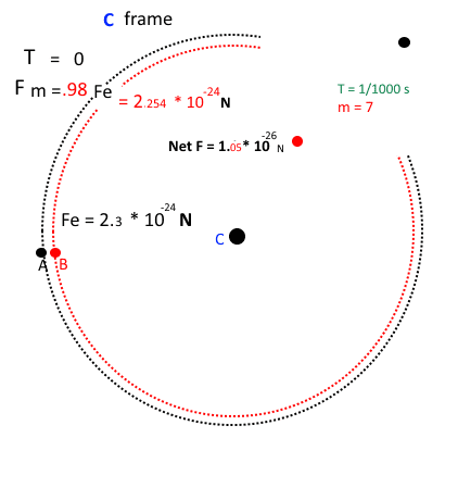

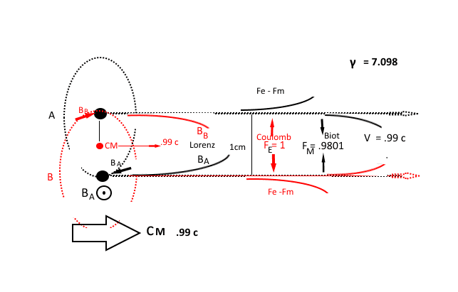

I am trying to understand magnetism and its relation to electricity:
Suppose there are two electrons traveling side by side in deep space at 1 cm distance at .99 c
In this article http://academic.mu.edu/phys/matthysd/web004/l0220.htm it is said that the ratio $F_B/F_E$ is $v^2/c^2$ for v << c. According to that formula the magnetic pull sould be .9801 times the electrostatic repulsion. Can you tell me
- 1) what is the actual value (applying relativity, since the speed is close to c) ? Is there a big difference? Intuitively it shouldn't be smaller, yet it can't possibly get greater than 1, can it?
- 2) what happens to the trajectory of the particles due to the influence of the mutual magnetic field, does if deflect from the straight line?

- 1) Is the attractive force greater than .98 or smaller? gamma is 7.09, right? center of mass is at .5 cm, what is the CoM force? The repulsive electrostatic force isn't affected at all by relativistic speed?
- 2) I am asking about the trajectories, are they bent from the straight line, besides the particles slowly separating?

1) Are you saying that the actual value of magnetic force is .9801 the coulomb force and no correctionis needed? Really? So, what is all the big deal of SR?
2. does magnetic field mutually generated (Lorenz force) make the trajectories converge? does this compensate the divergence ? Can you roughly figure out what happens to the particles after a seond or two?

1) Yes, it cannot exceed 1.
2) It will deflect.

Both electric and magnetic forces are part of the Lorentz force.
The electric force will always exceed the magnetic force so they will always diverge.

This might be the best question to start with. First, look at things in the rest frame of the electrons--or at least, in their rest frame at some instant. In that frame, there is no magnetic force; there is only the electrostatic repulsion between the electrons. So in this frame, they will accelerate away from each other.
Now transform to a frame in which the electrons start out moving parallel to each other at 0.99c. Since the relative motion of the electrons must be invariant, if they diverge in one inertial frame, they must diverge in all inertial frames. So they must diverge in this new "moving" frame as well.

The above analysis should show you that one way of viewing what we call a "magnetic" field is as just what you get when you look at an electrostatic field in a frame in which the source is moving. More precisely, it's a piece of what you get.
If you look at the Wikipedia page greswd linked to, that shows the transformation of the E and B fields, you will see, if we start from a frame where the field is electrostatic--i.e., where we have nonzero E but zero B--and then transform to a different frame, where the relative velocity between the frames is perpendicular to the direction of the E field (which in this case means perpendicular to the direction of separation between the electrons), you will see that the E field increases by ##\gamma##, and the B field in the new frame will be ##\gamma v## times the original E field. Since the force due to the B field has a magnitude of ##v## times the B field, the ratio ##F_B / F_E## will be ##v^2##. In other words, the formula that is valid for ##v << c## is also valid for ##v \rightarrow c##, as others have already pointed out.
Furthermore, if you work out the direction of the force due to the B field, you will see that it is the direction given by ##v \times (v \times E)##, which, using standard identities for cross products, works out to the opposite direction from the force due to the E field. So what is happening here is that, in the moving frame, the force due to the E field increases, but a B field appears giving a force that partially opposes the force due to the E field. The net effect is that the electrons diverge in all frames, and their diverging worldlines transform just as they should by the Lorentz transformation equations.

Isn't there a crucial point when the the magnetic attraction plus the Lorenz divergence will be greater than the electric repulsion? In LHC protons reach .999999991 c and therefore attraction is only 0.000000018 smaller than repulsion, can't Lorenz convergence be greater than that?

You can always transform into the rest frame of the particles. In that frame they repel due to plain vanilla electrostatic repulsion. They must, therefore, repel in all frames, or else there is a contradiction. A frame is simply a point of view. You can't make things that are moving apart start moving together by changing point of view.

That is right, so, how can repulsion (electric) become attraction (magnetic) in any other frame? Can you figure out the actual rate of divergence of electrons in all frames?

There is always a net repulsion. Your explanation for why this is so may vary. In one frame there is an electrostatic repulsion, while in another there is a stronger electrostatic repulsion and a weaker magnetic attraction.
Yes, you can figure out the rate of divergence in any frame. Probably the easiest way to do it is to work out the positions and/or velocities of the electrons as a function of time in their rest frame (more precisely the center of mass frame of the pair) and then transform those.
