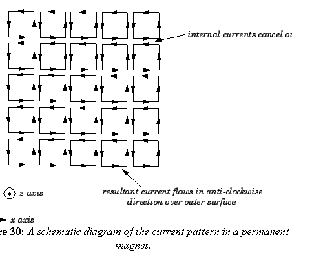

  • #46
Charles Link said:
For the illustration, I like to consider a square-shaped small current loop, so that it clearly cancels the current of the adjacent loop.
You are not alone. I found a lot of those before finding that circular one.
http://farside.ph.utexas.edu/teaching/302l/lectures/node77.html
I like the round ones because i think of atoms as round and electron orbits as circles - that's all.
old jim

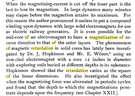

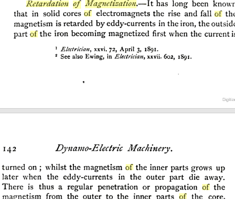

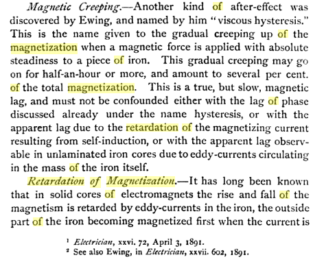

  • #49
A lot goes on in a simple piece of iron. I don't think you can write a general equation. From Sylvanus Thompson's 1896 edition of "Dynamo Electric Machinery"
oops sorry for overlapping snips.
I have an original 1901 edition and it's a delight .
Your question would i think be best answered by experiment on a specimen of the particular alloy, heat-treatment, shape, size, temperature, and recent magnetization that interests you.
A search on phrase "sylvanus thompson retardation of magentization" also turns up the 1903 edition of his book "Design of Dynamos" with some similar paragraphs. Some of his books are reprinted in India, to the credit of educators there. You might find one an interesting addition to your library.
old jim

  • #51
old jim
you say that in short there is no equation related to required time to reach steady state magnetic field and how magnitude of specific point's magnetic field changes until reaching its final magnetic field magnitude(steady)??
