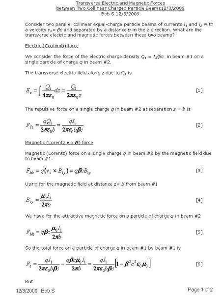

The relativistic expression for dp'/dt of a particle due to another particle is given by:
[tex]\frac{d{\bf p'}}{dt}=\frac{qq'[{\bf r}+{\bf v'\times(v\times r)}]}<br /> {\gamma_v^2[{\bf r}^2-({\bf v\times r)^2}]^{\frac{3}{2}}}.[/tex]
But, this is only true for the first particle moving with constant velocity v.
If that particle accelerates, which is likely, then the equation becomes more complicated and requires use of the retarded time, making it almost intractable.

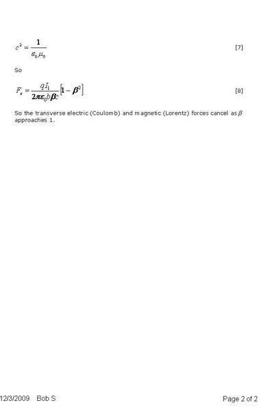

For two parallel or anti-parallel charged-particle beams, there are both Coulomb and magnetic forces. The forces are essentially the same for individual particles and for particle beams, but understanding the beam-beam interaction is a little easier than the particle-particle forces because of the transient effects with individual particles. The Coulomb force and the magnetic force are opposite for parallel beams, and cancel for very relativistic beams. See attachment. For anti-parallel charged-particle beams, the Coulomb and magnetic forces are additive.The same equations in the attachment can be used, but the sign of the force in equation [3] et. seq. should be changed. For currents in wires, there is no Coulomb force between the wires.
Bob S
