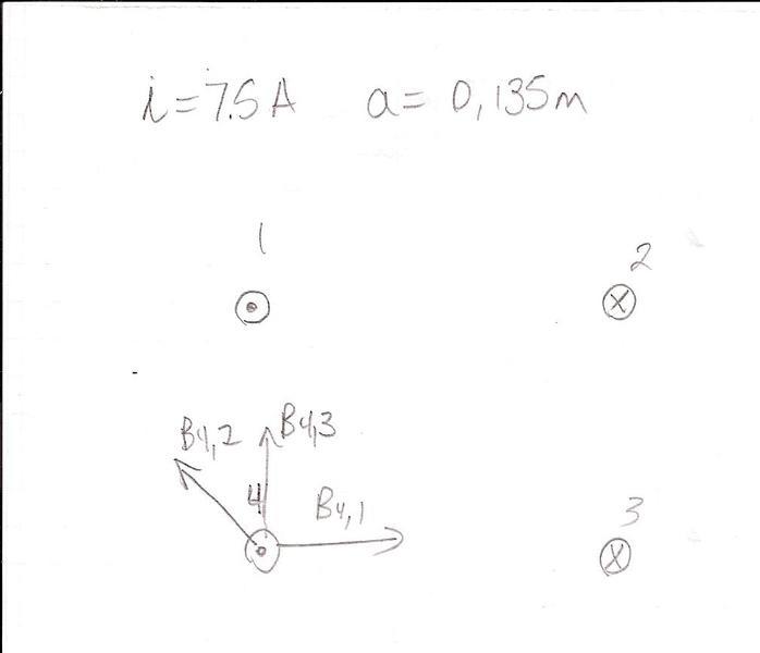

See figure attached
I've attempted to draw the magnetic fields resulting at the location of wire 4 due to wires 1, 2, 3.
I denoted them as B4,1, as in the "The magnetic field at 4 as a result of 1".
Are these correct?

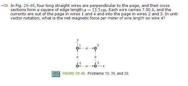

I've been having a really tough time finding the resulting magnetic force for this problem, I want to make sure I've got the first few steps right.
I know that the net magnetic field at 4 will be perpendicular to the current in wire 4 regardless.
So to find the force all I need to do is apply,
F_{B} = iB (We are calculating per meter of wire length)
Is this correct?
How do I get the force in its components if I want?
Thanks again!

It all looks good. You'll have to resolve B4,2 into its x and y components and add them to the purely x B4,1 and purely y B4,3 to get the total force in each direction.

Okay so,
EDIT: Whoops calculator was in radians,
B_{4,1} = 1.11*10^{-5}T
B_{4,2} = 7.86*10^{-6}T
B_{4,3} = 1.11*10^{-5}T
Breaking B4,2 into its components,
B_{4,2x} = 5.55*10^{-6}T
B_{4,2y} = 5.55*10^{-6}T
So the net B's of each component,
B_{xnet} = 5.54*10^{-6} \hat{i} T
B_{ynet} = 1.67*10^{-5} \hat{j} T
Do I now use,
F_{B} = iB
to calculate the forces?
I agree with the 7.86 x 10^-6.
But after multiplying by cos(45) I get 5.55, not 6.98.
Add the x components, add the y components, then use F = i*B.

I'm getting this as the final answer,
(-125 \mu N/m)\hat{i} + (41.7 \mu N/m)\hat{i}
Yes, agree. Tricky business getting the directions of the forces!
