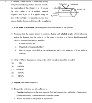

i have done the first two parts but the third part confuses me
i am assuming the current is flowing in the z direction then current is parallel to the magnetic field then why would there be a force acting on it ?[/B]
i am sorry for the poor quality
a constant 10MA current flows through the long hollow conducting cylinder initially of outer radius of 1cm and inner radius of a . A uniform external magnetic field of 1.0T is applied along the axis of the cylinder.for calculations you may assume the thickness of the cylinder is negligible
qn) calculate the force acting on a thin shell of current r and r + Δr where Δr << b-a ?
once again sorry
i am thinking there is no force as the current is parallel to the magnetic field

In the region a < r < b there is a second B field, one set up by the current, . As shown in your illustration, this field is in the θ direction. The ensuing force will be in the r direction and so will tend to expand the outer radius, which is why the problem states "initially of outer radius b".
I have made slight corrections to your posted text.
You're right, the externally applied B field is in the z direction and so exerts no force on the cylinder.
You probably also need to modify your answer to (b) ii.
i am not really too familiar with cylindrical coordinates but if a current were to set up a magnetic field would it not be curling around it and not in the theta direction as shown in the diagram in this problem the theta is perpendicular to r unit vector and the wire ie magnetic field is originating from the wire which i thought is not possible am i missing something please help me clarify?
2)
this one confuses me too because i have been brought to believe that something is not affected by the fields it produces in this case the magnetic field does not affect the wire
please help me clarify thanks once again

"Curling around it' is in the theta direction! Just apply Ampere's law to a B loop within a < r < b.
That's a very general statement, and incorrect. It's true for example that a charge is not affected by its own E field alone but certainly a current can produce its own B field, including within the current that causes it! And so the Lorentz force can exert a force on the shell.

B = \frac{J \pi(r^2 - a^2) \mu_o}{2 \pi r}\\
I = J 2 \pi r dr\\
df= I L B\\
df = L \frac{J \pi(r^2 - a^2) \mu_0}{2 \pi r}J 2 \pi r dr\\
df = L \mu_0 J^2 \pi(r^2 - a^2) dr
is this the answer for the question
is the force radially outward

the question is a bit nebulous IMO so I would say it's OK.
If you set up the coordinate system the way I described,
dI = dI k
so B =
B θ
and dF = I (dl x B)
which tells you the direction of dF.
Or you can pick a point. say x = r, y = 0 where B is in the +j direction so that k x j = -i
which come to think of it is radially inward and so will tend to contract the shell's radius rather than expand it as I told you earlier. Sorry!

Total current as given: 10 mA.
and why is it inside all along i have assuming the force was acting outwards
Pick any point along the contour r. Let's pick x=+r, y=0, z anywhere 0<z<L. Current in the +z direction so B is in the +θ direction which at that point is the +y direction. So at that point,
F = iL x B
L = L k
B = B j
k x j = -i
in other words, inward.
You can pick any other point along the contour, the result will always be the same: the force is inward. The effect is to squeeze the cylindrical shell inwards all around the circumference.

when a is changing only the area of the hollow is changing meaning the external magnetic flux through the cylinder is changing but so far the external magnetic field has not had any effect on the system
still doesn't
furthermore changing the b also only changed the solid cross sectional area but the question stated the current through it is constant 10MA so there might not be any change in the magnetic field caused the current
Mag. field is unchanged for r > b and r < a. But a or b or both might change ... up to you to figure out which.
so my guess is that there would only be mechanical effects rather than any magnetic effects
for example maybe the pressure maybe taking effect due to the changes ??
i am sorry if i am still not seeing what you are driving at
would be of much help if could give some more hints
I don't know how else to reply. Maybe you should read my previous posts a bit more thoroughly.
this is the best i could try i am not lying
no matter which a or b changes the magnetic field at r>b is not changing due to the fact that the current through the wire is constant
the area of the wire just changes accordingly to which radius change that is simple enough
isn't that all the question is asking it asked how the magnetic field changes how the area changes and how the magnetic flux changes
i don't see the point in this question
maybe you should just give me the answer to just this part if i am still getting it wrong ?
1. for a < r < b what is the B field?
2. then what is the force on a thin annulus at r?
3. what might that force do to that annulus if the metal were soft enough to deform under pressure?
4. considering that the cylinder is made up of many such thin annuli, what is the cumuative effect on the cylinder?
firstly sorry for the extremely later reply my o levels are coming and my prelimaries were going on so very sorry
ok i am answering your guiding questions
1)
B = \frac{\mu_0 I_0}{2 \pi r} \frac{r^2 - a^2}{b^2 - a^2}\\
2)\\
f = dI (L X B )\\
3) the annulus would contract under the pressure
4) the cylinder would too contract under the pressure
is it correct?
now i know what my question is
the previously calculated 32 gpa of pressure where exactly is it acting on the outer curved surface area
how to calculate the effect of pressure on the cylinder?
and the question asking what is requilibrium seems to suggest to me that at the r equilibrium there is pressure from inside the cylinder acting outwards that is balancing the 32 gPa is that true and what force is causing that?
thanks for your understanding and sorry once again
