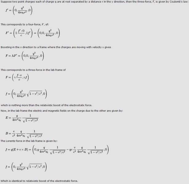

This is very nice analysis, how can time (from twin paradox) be relative when effects are totally absolute !
  • #96
DaleSpam said:
As I stated above, I mis-read your OP. The scenarios that I described using the LT correspond to your scenario (1) and to the LT of (1). They do not correspond to your scenario (2). I identified the modification that you would need to make to (2) in order to make it physically equivalent to (1).
They are different.
It doesn't. The link I provided uses the LT to analyze the same scenario from two different reference frames. The scenario analyzed in the link is not the same as your (1) or (2).
But if you apply charge-symmetry, then I think we should be able to transform the two scenarios.
That is, scenario(1) is exactly in conjugation with the scenario(2) according to C-symmetry.
Do you still believe the two scenarios are different and we cannot transform one to other.
Sure, but that is not a Lorentz transform. The Lorentz transform preserves charge.
Also, you would have to have completely symmetric charge carriers, i.e. no high-mass fixed "lattice" and no low-mass "free current" charge carriers. For real wires and currents you cannot transform (1) into (2) even including both charge conjugation and a boost.
EDIT: Actually, even with symmetric charge carriers you cannot change (1) into (2) because in one the test charge is at rest wrt the same polarity charge carriers and in the other the test charge is at rest wrt the opposite polarity charge carriers. Changing charge conjugation doesn't change that discrepancy.
While (1) and (2) are both perfectly valid scenarios, you cannot simply Lorentz transform from one to the other. So relativity is not going to explain them.
