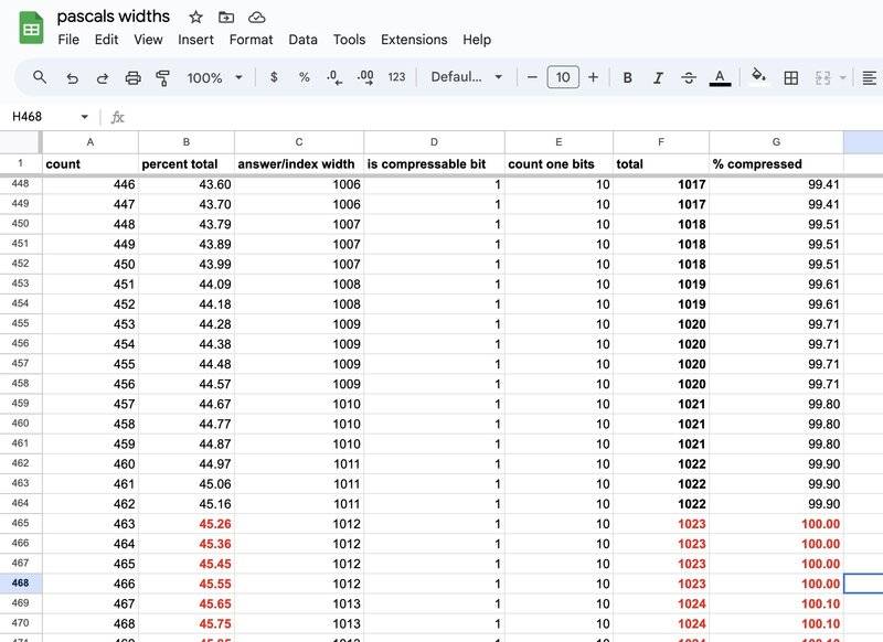

also, here are of my more recent work based on combination / permutations. and yes, you can use it to compress data (sometimes)
some permutations:
parsing compression level, or if not-compressable with default data input:
[Personal e-mail address redacted by the Mentors]
@raminee
If you look close enough (in attached image), you can see where compression becomes achievable. not a lot mind you, but there is the possibility or running cycles (compress the compressed data).
Really the hold up is the input data. If all data was 45% pop-count and below, or 55% pop-count and above, you could compress it all. The tricky part is that most data is 46% to 54% pop-count :P That is when dealing with data that is 1023 bits wide (size per data chunk / sector). I have implemented variable sector size versions of this BTW.
For larger bit widths, like 8191 bits wide... it is closer to: 48% pop-count and below, or 52% pop-count and above being (minimally) compressible.
