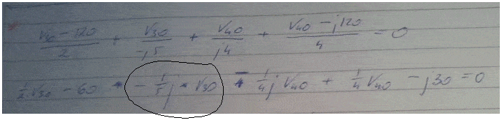

that is what coursework shows using substitution

I can't comment on what I don't see. Can you show more of your work?
  • #49

Page 2

  • #51
I bet you smiling now ;)
  • #52
Check the sign of the term.
  • #53
before I go further -55.74 - 20.06j + 0.25 V40 - 0.05 j V40 ?
  • #54
I'm not seeing where that's coming from. Sorry.
Did you make a V30 substitution? Really you should eliminate V40 instead, since you need V30 to find the current through Z4.
