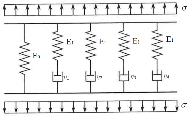

Hello guys,
actually I'am working on a model to describe the creep-behaviour of a concrete specimen. This model is based on a 'generalized maxwell-chain'. I attached a picture, where you can see it:
The acting load is the tension [itex]\sigma[/itex], while [itex]E_0[/itex] and [itex]E_1[/itex] are the stiffnesses of the Hooke-springs and [itex]\eta_i[/itex] are the viscosities of the Newton-dashpots.
All these parameters are "hidden" in the parameters [itex]a_i, b_i[/itex] of the constitutive equation which describes the behaviour of this model by:
[itex]b_0\cdot\epsilon+b_1\cdot\dot\epsilon+b_2\cdot\ddot\epsilon+b_3\cdot\dddot\epsilon + b_4\cdot\ddddot\epsilon = a_0\cdot\sigma +a_1\cdot\dot\sigma + a_2\cdot\ddot\sigma + a_3\cdot\dddot\sigma + a_4\cdot\ddddot\sigma[/itex]
To simplify the whole problem, I assume that these parameters [itex]a_i, b_i[/itex] won't change within time.
Now I want to test the material by performing a "simple" creep-test. This means that at a time [itex]t[/itex], a tension [itex]\sigma > 0[/itex] is applied and stays constant:

If I want to know the resulting strain [itex]\epsilon[/itex] at the end of a time-step t-t0, i can solve the given equation which actually can be simplified to (because the [itex]\sigma[/itex] is constant in a time-step, all of it's derivatives are zero):
[itex]b_0\cdot\epsilon+b_1\cdot\dot\epsilon+b_2\cdot\ddot\epsilon+b_3\cdot\dddot\epsilon + b_4\cdot\ddddot\epsilon = a_0\cdot\sigma[/itex]
This is a fourth-order ODE with constant coefficients that can be solved analytically. In a time-step based calculation, I have to solve the equation for each time-step by the formulation of correct initial conditions. ... and there is the problem:
If I want to get the strain et the end of the time step [itex](t = 3,001) - (t_0 = 3)[/itex] I mean that the initial conditions for the [itex]\epsilon, \dot\epsilon, ...[/itex] are:
[itex]\epsilon(t = 3) = 0 + \frac{\Delta\sigma(t-t_0)}{E_0 + 4\cdot E_1}[/itex] (at the begin [itex]\epsilon[/itex] is zero, but there's always a kind of elastic deformation, when some stress is applied)
[itex]\dot\epsilon(t = 3) = \frac{\frac{\Delta\sigma}{t - t_0}}{E_0 + 4\cdot E_1}[/itex] (this is the velocity of the elastic strain)
[itex]\ddot\epsilon(t = 3) = 0[/itex] (I guess ... but I am not sure)
[itex]\dddot\epsilon(t = 3) = 0[/itex] (same here ...)
So far so good. If I come to the next time step [itex](t = 4) - (t_0 = 3,001)[/itex], I have to solve the equation again. Now with different initial conditions:
[itex]\epsilon(t = 4) = \epsilon(t = 3,001)+ \frac{\Delta\sigma(t-t_0) = 0}{E_0 + 4\cdot E_1}[/itex]
[itex]\dot\epsilon(t = 4) = ...[/itex] I don't know what... (I don't think that it is [itex]\dot\epsilon(t = 3,001)[/itex] and I also doubt that it is zero ...)
[itex]\ddot\epsilon(t = 4) = ...[/itex] (same here ...)
[itex]\dddot\epsilon(t = 4) = ...[/itex] (same here ...)
I hope I described the problem good enough that someone can help me ... this would be great!

Do you have to solve it in the exact form of the differential equation you have written, or are other methods also acceptable?
Chet

This is not how I would approach a problem like this. I think that trying to solve it analytically for the case of 5 elements present is daunting. The fact that they were able to solve it analytically with 2 elements present is very impressive.
I would approach this problem numerically, using the relaxation spectrum version 10.3.32. At each time step, I would put in a strain increment, and determine the corresponding stress increment. Then I would appropriately adjust the strain increment so that the stress increment comes out to be zero.
Of course, you could take the Laplace Transform of the relaxation spectrum version 10.3.32, and then solve for the Laplace Transform of the strain (for a step function stress). But being able to invert the resulting transform analytically would be a long shot.

You need to go back to 10.3.29 and integrate across t = 0.
Chet
Uh ... that was it.
Now I got the solution ... unfortunately I am not sure, whether I really understood the background of this procedure (the 'why' to integrate the constitutive equation) as well as the things, I mentionned in the following:

For the second term, we know sigma at both sides (the function of sigma is a kind of "stepfunction" in this case): sigma(t+DeltaT) = sigma0 and sigma(t-DeltaT) = 0.
The third term contains the first derivative of the function of sigma which describes our loading. As the "function" sigma is zero at t-DeltaT, dsigma/dt at this point should also be zero, because there is no change of sigma here; after loading the system with sigma0, it stays constant. Because every constants derivatives are zero, we can say that dsigma/dt(t+DeltaT) is zero as well ...
I see what you are saying. That makes sense.
I wish I could have helped you out more on this, but I'm out of ideas.
