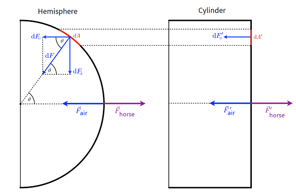

Here is the reason why the formula is correct:
The evacuated Magdeburg hemispheres are affected by the difference of external and internal air pressure ##\Delta p## which presses them together. To calculate the total force on one of the two hemispheres, we consider a surface element ##dA##. The ambient air exerts a force ##d\vec{F}## on this area that is perpendicular to the surface element and of an amount ##dF=\Delta p\,dA\,.## However, we are only interested in the horizontal part of this force ##\vec{F}_{\|}## which is parallel to the direction to which the horses pull, i.e. parallel to the horizontal symmetry axis of the hemisphere. The perpendicular components ##\vec{F}_{\perp}## cancel themselves out. If we denote the angle ##\varphi## between the normal to the surface and the direction of pull, then the parallel component has an amount of
dF_{\|} = dF\cdot \cos \varphi = \Delta p \;dA\cdot \cos \varphi =:\Delta p\; dA'=:dF'_{\|}
The quantity ##dA'=dA\cdot\cos \varphi## can be viewed as parallel projection ot the surface area ##dA## onto a cylinder (see the figure).
The parallel component ##dF'_{\|}## of the force which the air pressure exerts onto the projected surface area element ##dA'## is thus of the same amount as the parallel component ##dF_{\|}## of the original force exerts on the original surface element ##dA\,.##
The total amount of force exerted by the air pressure onto the hemisphere is the sum of all forces over the surface elements which compose the hemisphere. Since ##dF_{\|}=dF'_{\|}## we have for the total amount ##F_{air}=F'_{air}##, the force onto the projection. So the two hemispheres are pressed together as two cylinders were, whose diameters correspond to the section of the hemispheres: ##R##. The force of air pressure on a cylinder is easy to calculate. It's simply the product of pressure and circle area: $$F_{air}=F'_{air}=\Delta p \;A_{\circ}=\pi R^2 \Delta p$$
The example then calculates to a force of
F_{air}=\pi \cdot (0.3)^2 (1.013-0.1)\;10^{5}\;N\approx 26\;kN
which each group of horses has to come up with in order to separate the hemispheres. For comparison: One horsepower is approximately ##735.5## Watt, so ##30## horses would produce ##22\;kW##. A horse pulls with approximately ##10-12\,\%## of its weight, i.e. with ca. ##700\;N## or ##21\;kN## for ##30## horses.
