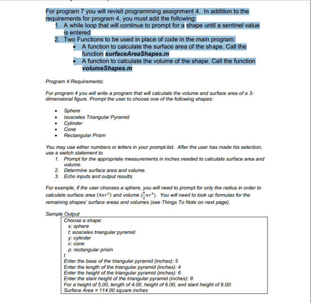

*see attachment*
Alright, so we just began messing with functions in our class and I'm kinda struggling to grasp this assignment. I believe it should begin like this:

now that I called the functions, now I have to make em...(surfaceAreaShapes.m and volumeShapes.m) This is where I get super confused. I have a general idea that I'll perform an if/switch statement in order to call up the right formula that corresponds with the shape the user inputs. Just not real sure on the correct formatting of a function.
...Heres what I got for surfaceAreaShapes.m
area=surfaceAreaShapes(radius);
the parameter radius I set doesn't seem like it would make sense considering I will have other things that will need to be put in in order to determine area.
*sorry in advance its not indented properly. That bugs the hell outta me
