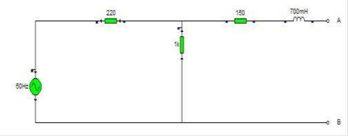

Determine, for the network shown in fig 4 the value of the load
Impedance that will dissipate the maximum power and the value of
this power.
Using Thevenin theorem to simplify the circuit then,I believe maximum power transfer theorems apply.
P=I2R
R=√(R2+x2)
I=E/Zt
Zt=z+R
But E is in Hz not in Volts?Do you think it could be a printing error?

Thevenin Impedance
Thank you for your reply.I calculated Thevenin impedance.Calculation below:
R1=220Ω
R2=1KΩ
R3=150Ω
(R1xR2)/(R1+R2)=(220ΩX1000Ω)/(220Ω+1000Ω)=180.32Ω
Resistance of L1
Zl=2πfL=2xπ50x700x10-3=220Ω (round)
R3+RL1=150Ω+220Ω=370Ω
ZTH=180Ω+370Ω=550Ω
And then?
Careful with the inductor. The inductor has impedance, an imaginary value, not a real values resistance. ZL = jωL.
How ω can be calculated?There is no ω?
ω is the angular frequency. ##\omega = 2\pi f##.
Thank you
ZL = jωL=j2πfL=j220
R3+RL1=150+j220
ZTH=180+150+j220=330+j220
OK.I calculated Zth what should I do next?Thank you
shaltera said:
ZL = jωL=j2πfL=j220
R3+RL1=150+j220
Looks good. Don't forget that the units of the impedance is still Ohms, just like resistance.
Sorry I forgot to add Ω at the end
330+j220Ω

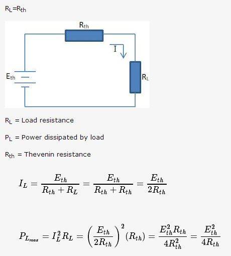

The maximum power transfer theorem states: A load will receive maximum power from a network when its resistance is exactly equal to the Thevenin resistance of the network applied to the load.
Yes, that's true for resistances. There's a bit of a twist when impedances are involved since there are separate real and imaginary quantities that interact through the mathematical operations. The result is still very simple though. Look at the last line of the Wikipedia article...
