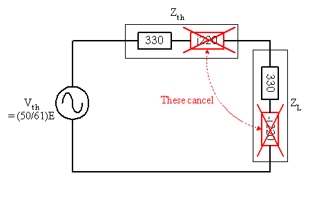

One way to grasp the reason for the result found is that reactances do not consume real power. They store and return it (a capacitor charges, storing up energy (1/2)CV2 on one half of the cycle, but return that same power to the source on the discharge half of the cycle. The same goes for inductors) The power that accomplishes this, while not lost, is not consumed by the load, and the source still has to be able to provide and recover it on every cycle.
So the way to avoid this waste is to choose the reactive part of the load impedance so that when added to the source impedance the net result is purely resistive. Then you're left with just the source resistance and load resistance to deal with, which is the case solved in your post (I see you've changed that. Oh well...).
  • #42
The power dissipated should end up being a real value only. Imaginary power is not dissipated by loads.
You still have not taken in the conclusion of the derivation shown on the Wikipedia page!
You correctly calculated the source impedance in post #8. The required load impedance can be written by inspection from that value. Look again at the last line of the derivation on the Wikipedia page. It tells you how to write the load impedance from the source impedance; they are complex conjugates.
The answer you supply for the actual power dissipated should be a real value, and it should leave the source voltage in symbolic form ("E").

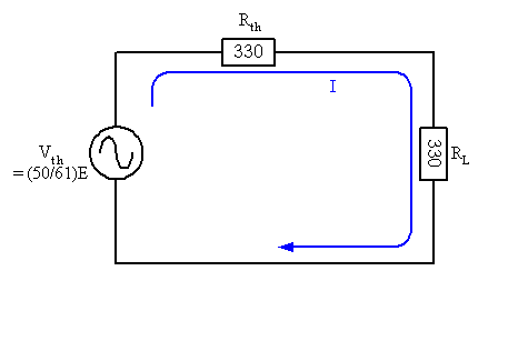

Just let the source voltage be the symbol "E". Then your Thevenin voltage is (1000/1220)E.
Now, what impedance does this Thevenin voltage "see" when the circuit is complete?

  • #55
Draw the circuit --- components are Vth, Zth, ZL. Plug in the values of Zth and ZL. What is Vth "seeing"?
  • #56
What's the net equivalent impedance?
  • #57
Zth?
  • #58
shaltera said:
Zth?
What is Zth? What is the load impedance ZL? How are they connected in the circuit? What then is the net impedance?
