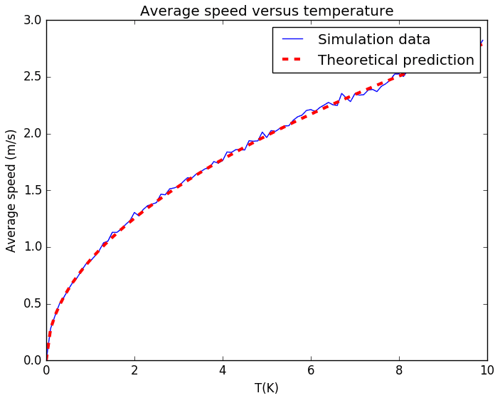

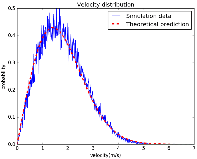

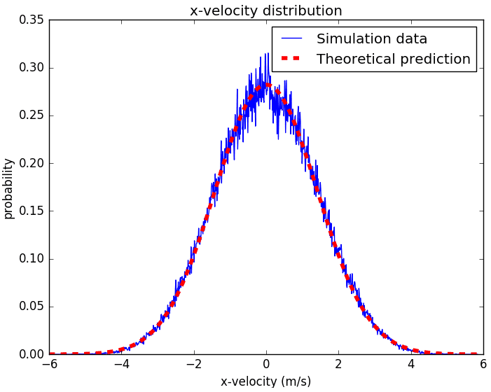

I did exactly this for a Python class that I took years ago, here are some results. The simulation I wrote involved circular balls bouncing around inside of a spherical cavity, the initial positions and velocities were evenly distributed and eventually thermalized by allowing the spheres to collide for some amount of time. The results below were obtained with around 100 balls averaged over a large number of runs. Let me know if you need any help writing something like this.
It would be amazing to ask you something more "in detail", I texted you privately.
