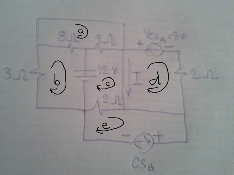

Find the value of CSB(current source B) and determine the value of I.
Mesh equations
mesh:
a -> Ia = 0
b -> 11Ib = -12
c -> 6Ic = 12
d -> 2Id = -8
e -> Ie = -CSB
Ic = 2 A
Id = -4 A
then I cannot further continue this one... :(

Your diagram indicates CSA = 8V, but isn't it a current source? Or is this supposed to represent the voltage that the current source happens to be producing in order to maintain its (unspecified) current?
