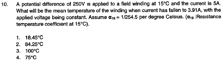

Multiple-choice physics question: a 250V potential difference across a field winding at 15°C, current 5A falling to 3.91A, alpha15 = 1/254.5 per °C; options 18.45°C, 84.25°C, 100°C, 75°C.

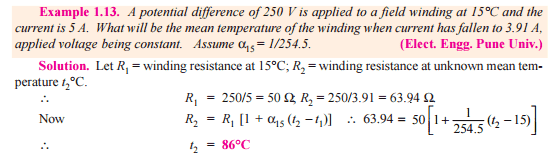

Worked solution from a textbook: Example 1.13 on a field winding's resistance at 15°C and an unknown mean temperature t2, with R1 = 250/5 = 50 Ω, R2 = 250/3.91 = 63.94 Ω, and 63.94 = 50[1 + (1/254.5)(t2 − 15)], giving t2 = 86°C.

It is from B.L. Theraja. The page looks familiar. The red line in the above post is your error.
