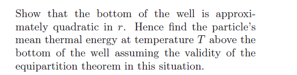

## V(r) = \frac 1{r^3} \left( A - Br^2 \right )##
At the bottom of the well, r is verry small.
So, ## V(r) = \frac A{r^3}##
Assuming the validation of Equipartition of energy theorem, since the degrees of freedom is 1,
the particle's mean thermal energy is ##\frac { k_B T} 2##.
Is this correct so far?
Where does the 3 come from?
Does that show that "the bottom of the well is approximately quadratic in r"?
I have taken n= 3.
No, this is the problem. The question says to show it in quadratic form, but it is not so.
Leave ##n## alone. Suppose you were to find at what value of ##r=r_0## the potential has a minimum. Consider placing a particle at that minimum and displacing it slightly. What kind of motion do you think it will undergo?
