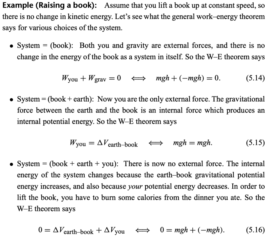

Though I don't think this is an approximation, but rather bending the rules to make things simpler. The following is from Morin
Once we've clearly defined the boundaries of our system, it's difficult to see how a potential energy term in an external field fits in. For instance, in the first "book" system, we don't consider any potential energy.
Of course, we could do an algebraic substitution of a potential energy term, but this seems to be slightly misleading.

Alright, how about this.
All potential energies are internal to a system. If we include a term for a potential energy in an external field, we are effectively describing the energy of a system including that external source, however we can ignore this technicality in practice since it doesn't affect the question.
And in the case that there are no source particles (e.g. centrifugal potential energies), this potential energy is internal to the system anyway.
So at the end of the day, we can still only have internal potential energies. But there is a little bit of wiggle-room for defining the system boundaries in general practice.
