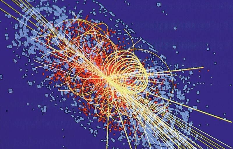

It seems as if a series of very precise position measurements has been performed on the fields involved. If the fields are collapsing in momentum eigenstates, wouldn't this very precise position data violate the uncertainty principle?
Jdeloz828 said:
Thanks for the reply! Hmm okay, so they're in an eigenstate of the momentum operator when the measurement is performed, but then what do we make of the particle tracks such as those seen in the image below:
View attachment 293309It seems as if a series of very precise position measurements has been performed on the fields involved. If the fields are collapsing in momentum eigenstates, wouldn't this very precise position data violate the uncertainty principle?
That looks like a much more complicated scattering event where jets of particles emerge in all directions. The HUP is a statistical law. To violate it, you would need a state where the range of position measurements and the range of momentum measurements for a single particle both have sufficiently small standard deviations. I see no evidence of that at all in that diagram!
It appears that you are treating QFT as some sort of add-on to non-relativistic QM. This is not the case at all. QFT is a different ball-game altogether. You can, of course, recover non-relativistic QM, the SDE and the HUP in the appropriate limits. But, QFT itself is significantly more mathematically and conceptually sophisticated than QM. And, it's not always obvious how QM emerges from QFT.

I suppose I'm still somewhat confused, but I think we're getting somewhere. Going back to the image above, I'm wondering how we break the image up into measurements where collapse is taking place. Can we break up each track into equally time spaced blips and all such collections of blips constitute a collapse of the fields involved? And are these collapses measurements of position or momentum?
Okay, but this is a more fundamental question about how particles can exhibit approximately classical trajectories despite the HUP. The answer is that the tracks in a cloud chamber, for example, are simply not precise enough measurements of position to disrupt the approximately classical trajectories of circles and straight lines. If you analyse the uncertainties of position in a picture like that, they may be several orders of magnitude too coarse for the HUP to be significant.
Ultimately, we know that electrons can follow approximately classical trajectories unless we try to pin them down too closely, at which point the HUP and the constraints of QM show themselves.

Gotchya. So am I correct in assuming the image can be broken up in a series of position measurements? Or should it be thought of as a series of momentum measurements?
Technically, we have a series of position measurements. From which the (classical) momentum of a particle is inferred. For example, presumably there is a magnetic field present, from which the charge and momentum of the particles are inferred. As before, the HUP does not prevent charged particles being observed moving (approximately) in a circle of a given radius in a magnetic field. For practical purposes we may see apparently classical trajectories following the laws of classical electrodynamics! But, critically, it's QFT and modern particle physics that explains which particles or jets of particles emerge from high-energy interactions. That's where QFT does its job.

Building on my previous reply. I suppose we can think of the image as a series of both coarse position and momentum measurements, and what you're saying about the coarse position measurements not disturbing the classical trajectories makes sense if the states are not collapsing into pure position states, but rather some sort of localized state that retains a degree of imprecision. In this way the momentum information the state possessed prior to having it's position measured is no longer lost the moment the position is measured. That would definitely clear things up, but I never see in textbooks examples of particles/fields collapsing into somewhat localized states. Can we form hermitian operators for which the eigenstates are the states resulting after collapse associated with a coarse measurement?
I think you have stumbled on the point that measurements in experimental physics are not the explicit measurements of elementary theoretical QM, but more subtle in nature. Let's take the spectrum of hydrogen as an example.
