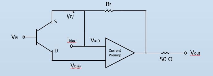

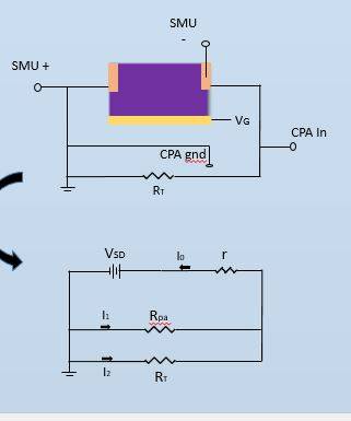

Hello all,
I am interested in measuring the photoresponse of a transistor with a fixed source-drain bias. I would like to feed the drain current into a current preamplifier and output the preamplifier signal to another location. The preamplifier has a very low current maximum, so I will use a current divider. The preamplifier has a known input resistance.
I am using an SMU to provide a constant VSD, and it is important to be able to fix this potential at whatever value I want. I have attached what I can come up with, but I am not sure this is the best approach...
In the cartoon below, I draw a cartoon and a (at least I think so) equivalent circuit. I have modeled the SMU potential across the SD as a battery with resistor in series. The CPA (Current preamplifier) is also modeled as a resistor. I believe the input has to be in series with I1 (current measurement).
I have also included equations for what I think will be I1 and I0.
Any advice for whether this looks reasonable, or improvements would be greatly appreciated!
Thanks.
It's unclear to me how you are ensuring both a fixed source-drain voltage and using a resistor as a current divider.
It would seem either VSD will change with the current across the resistor, or the current will not be evenly divided if you somehow keep the input to the current amplifier at a constant voltage level.

Jeff - The idea was to have the current preamplifier and RT in parallel with the SMU. The SMU is very good at fixing a voltage and supplying whatever current necessary to force that voltage.
Baluncore - The CPA is made by Stanford Model SR570. It can provide a +- 5V bias, so I may just end up using that as the source-drain bias. I selected this because I had no other choice, and I would like to make it work. It is a good piece of equipment, I just need to provide the correct signal input to utilize it properly. Thanks for providing that drawing! That is really helpful. I will have to think about it for a little while to see if it will accomplish what I need.
Currently I am thinking of operating with this set-up:
The main issue is that the current preamp can only provide a 5V bias, and I would like to operate an order of magnitude higher.
So from here I will have to see if the circuit Baluncore suggested will work..
Thanks!

So the way you have VDS set up won't the current just flow from + to - side of the SMU? I don't see why the current would flow through the transistor if it has a direct path from + to -...

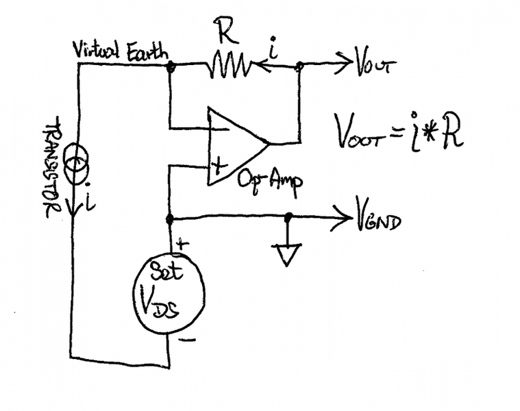

First some clarifications.
1. What does the acronym SMU stand for?
2. The topic title “Measuring current across biased transistor” refers to current. Current flows “through” a device while voltage appears “across” the device. There is a possible misunderstanding of the question.
3. As I understand it, the SD voltage will be fixed while the photo-current flowing will be measured.
4. What will be done with the gate voltage?
My circuit in post #3 is designed so the inverting (–) op-amp input is maintained at zero potential.
The op-amp inputs require no current, they sense voltage.
The SD photo-current, i, flows through R.
The op-amp maintains an output voltage so that it's + and – inputs are zero.
The op-amp output voltage is therefore Vout = i*R.
The “Set VDS” is a ground referenced DC supply that sets the SD bias.
You do not need to use a resistor as a current divider, you select an appropriate value for R.

SMU stands for Source Measure Unit. The basic idea is that it can provide a very responsive constant voltage across a varying resistivity. As a variety of light frequencies impinge on the transistor, the resistivity of the channel will change very quickly. The SMU provides a constant voltage to account for this change in resisitivity. The idea of this system is to fix the voltage across the transistor, and measure the current through it. In the diagram you presented, what will be the load that the power supply (SMU) "sees"? If it's connected across the transistor, then it will see the resistivity of the transistor. The way you have it drawn, there is nothing in between the + and - sides, so how will the current change as a function of transistor resistivity?
The gate voltage is independent, and will be fixed at a certain voltage by another SMU.
Thanks for the insights! I haven't done any electronics work in a while, so I may have some fundamental misunderstandings holding me up...
Do you understand how opamps work? There is very very high gain between the + and - input differential and the output. For example -1mV on the - input (0v on + input) might cause 10V on the output (if the open loop gain were 10,000). This means that one can consider the - and - input to be nearly the same voltage unless the output has been driven to the supply or ground rail. so, put a X10000 inside the opamp triangle.In baluncore's circuit the + input is ground, so, if the circuit is working, the - input will be 0V. If there is 0 current through the transistor, then Vout will be 0V also.
There is a negative voltage connected to the transistor, call it Vds. If the transistor conducts, it would pull the - input negative, so the opamp creates a positive voltage at Vout to supply enough current through R to keep the - input nearly 0V.
Essentially, whatever current the transistor draws must come through R (notice his "i" arrows in the R leg and the transistor leg). As he annotated, Vout = i*R.
Since the circuit action keeps the - input at nearly 0 volts, then the voltage across the transistor never changes, but the output voltage changes with transistor resistance.

meBigGuy has covered most of the points.
My "set Vds" is an adjustable low impedance voltage source. It is ground referenced and only has to provide the current that flows through the photo-transistor. The important thing is that it sets Vsd and that Vsd is independent of SD resistance. An identical unit can supply the Vgs you need for the gate.
