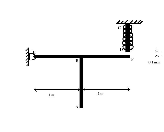

Hey Guys, here is a skeleton for an exercise I need a help with:
In this Problem we have a beam EF which is pin-supported at E, a Rod CD which is enrolled by a spring ( spring constant =k) and a rod AB (AB is touching the ground, I forgot to draw it).
If we heat the Rod AB what will be the equation of equilibrium and the compatibility equations to find the forces FAB, FCD and Fsp (the force of the spring).
(Gap between CD and EF is equal to 0.1 mm)
I just want to know the equations because I don't remember the rest of the numerical given.
Thanks everyone,
Dikimbi2.
Again Hi, sorry I forgot to show you what I did: (I had this in an exam):
Equilibrium equation: (Moment about point E) ME = 0 =>
FAB = 2(FCD+Fsp)
Compatibility equations: [(δAB)t – (δAB)F]/1 = [(δCD)F]/2 (Using Thales)
(δAB)t = αal. ΔT.LAB
(δAB)F = (FAB.LAB)/(AAB.EAB)
(δCD)F = (FCD + Fsp) / (kCD + ksp)
with kCD = (ACD.ECD)/(LCD)
The Other Compatibility equation is: (δ'CD)=(δsp)
δ'CD = (FCD)/(kCD)
(δsp = (Fsp)/(ksp)
