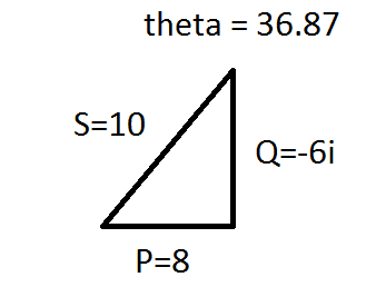

So complex power = 10 * I* = 10 * (0.8 - 0.6i)?
S = 8-6i
Power factor = P/S = 8/10 = 0.8 leading? (Q<0)
Does this triangle look right?
S = 8-6i
Yes. Also, write 'j' instead of 'i' in the imaginary part of the complex form (e.g
S=8-j6). That's a convention followed in order to avoid confusion with the symbol 'I' for current.
Can (should) I convert to VA form? (sqrt(P^2+Q^2))
Not necessary if apparent power is not asked. You can keep it in the complex form.
