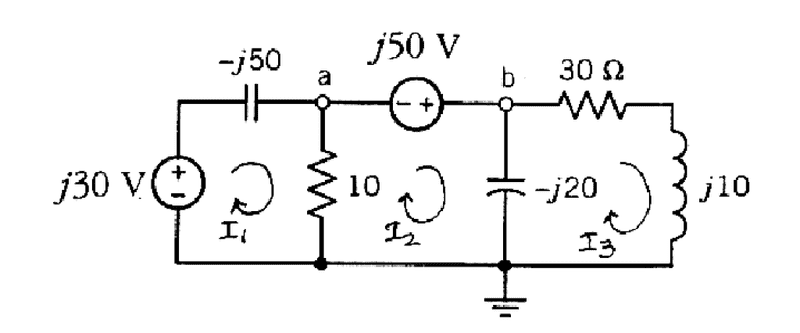

Circuit schematic with three mesh currents I1, I2, I3 and nodes a and b, showing a j30 V source, -j50 capacitor, 10 ohm resistor, j50 V source, -j20 capacitor, 30 ohm resistor and j10 inductor.
Use Mesh analysis to find voltage of Node A and B
V=IR
KVL
Are my mesh equations correct?
Mesh1:
-j30V + (-j50 + 10)I1 - 10I2 = 0
Mesh2:
(10-j20)I2 - 10I1 - j50V - I3(-j20) = 0
Mesh3:
(-j20+30+j10)I3 - (-j20)I2 = 0
gneill said:
Yes, your mesh current equations look fine.
How would I get the voltage of Node A and B?
Ohm's law. You've solved for the currents so now you can find the potentials across any components you wish. Choose a path from the reference node to the location where you wish to know the potential and sum up the PD's along the way.
So if I wanted the voltage at Node A, I would multiple (I1-I2) with 10ohm resistor?
That would work, yes. Any path from the reference node to a would work, and that happens to be a pretty convenient choice :smile:
I ended up getting:
14.329 < -71.74 degrees for Va
Is that right?Would Vb be: (I2-I3)*(-j20) -> 4.48 + 36.39j?

They look good to me.
Note that for Vb you could also have just added j50 to Va; there is a fixed source of that amount tying them together.
