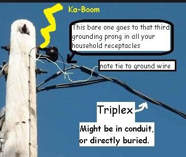

jim hardy said:
... sometimes it's a bare wire around which the other two are wrapped and strung overhead.
Yeah, I think we always called that... Triplex . ?
Likes jim hardy
The circuit breaker will disconnect the two power(Hot) conductors
but will not disconnect a Neutral or a Bonding conductor .
That's why (s?)he needs to verify they're gone.
Of course Janelle has an 80 foot metal tower not a wood power pole.
but principle is the same...
Lightning at top of pole has an all metal path into your house.
That bare copper wire down the pole carries a lot of it directly into earth. It goes to bottom of pole where it's wrapped into a spiral for max surface area to conduct as well as possible..
Ground rod at house service entrance helps too.
Still,
During that brief instant when it strikes the pole your household appliances are hardwired through their three wire grounded cords directly to the bottom of that lightning bolt. That's what almost got me.
@JanelleNica
That wifi tower is a lightning rod, as you suspect. Its wiring ought to be separated from your house wiring by as much physical distance as you can arrange.old jim

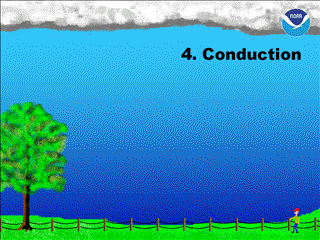

A picture is worth a thousand words.
OCR's link has a tab "How People are Struck by Lightning" with this dramatic picture :
(don't know why it's right shifted)
In your imagination,
Replace the tree with Janelle's tower or my power pole
and replace the fence with the ground wire going into a house.
Ground rods help divert strikes into the earth
but the kiloamps in a big lightning bolt will overwhelm them.
See also picture #3 just above, "Ground Current".

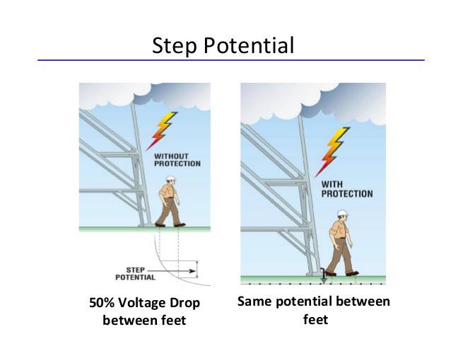

Pictures indeed.
Step Potential when ungrounded and when grounded.
