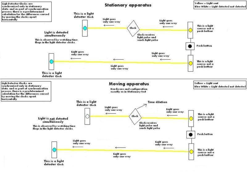

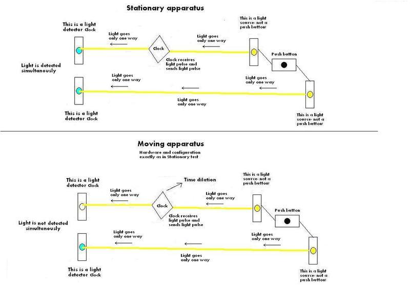

Thanks ghwellsjr,
One more pre exercise question...sorry, for asking questions indeed I don't need to prepare time in advance.
What is the relation between the current understanding of time dilation and clock synchronization? What I mean is this - If I make many times an experiment that shows me that 10 'ticks' of clock 1 (say a very precise clock etc...) are never the same as 10 'ticks' of an identical clock 2, because they are at different inertial frames - Then why can't I take these results and formalize them in such a way that I say: If there is inertial difference, 10 ticks of no.1 will never be the same as 10 ticks of no.2, and it has nothing to do with synchronization (although the results were achieved using synchronization).
Thanks,
Roi.

  • #112
ghwellsjr said:
As I see it, Lorentz took interpretation (2) because he assumed an absolute ether rest frame in which MMX was not at rest while Einstein took interpretation (1) if he assumed a reference frame in which MMX was at rest or (2) if he assumed a reference frame in which MMX was not at rest (one in which the sun is at rest, for example, or any other candidate for the presummed ether).
As harrylin pointed out here:
roineust said:
Thanks ghwellsjr,
Thanks,
Roi.
Hi Roi, it's not clear to me what you want to do, and how it relates to the topic... I agree that there is a fundamental difference, as clock synchronization is a human choice while time dilation relates to a physical phenomenon that also manifests itself for cases in which clock synchronization plays no role.
However, for inertial motion the two are interrelated. That is because if you want to measure the time between two ticks of a clock that is moving past your clocks, you need two synchronized clocks to do that. Alternatively, with only one clock, you can film the moving clock from a distance, but the correction for the propagation time is related to the clock synchronization which is simply based on a convenient speed of light assumption. So, although it implies a different speed of light in different directions wrt your frame, you can always adapt your measurement such that 10 ticks of no.1 will be (or appear to be) the same as 10 ticks of no.2. Does that help?
Harald
