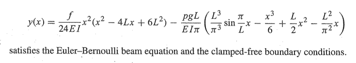

Printed equation: y(x) = f/(24EI) x^2 (x^2 - 4Lx + 6L^2) - (pgL/(EIπ^4))... with a bracketed term containing L^3/π^3 sin(πx/L), x^3/6, L x^2/2 and L^2 x/π^2, followed by the line 'satisfies the Euler-Bernoulli beam equation and the clamped-free boundary conditions.'
Prove that this equation satifies the Euler-bernoulli beam equation which is given by
Handwritten equation E I y'''' = f(x), the Euler-Bernoulli beam equation with a fourth derivative of y on the left and a load term f(x) on the right.
Boundary conditions written as y(0) = y'(0) = y''(L) = y'''(L) = 0.
Cany anyone help me with this. Can wolfram alpha do it? It has so many values and I'm not comfartble with doing 4th derivitives
You don't have to do all the derivatives. If you have some term like ax^n, where a is a constant, what is the min value of n so that the 4-th derivative is not zero? What is its value in the min case?
