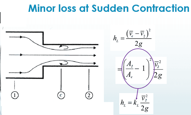

which formula is correct ? the formula in the first ? or in the second ? one is using the mean velocity , while the another one is using velocity difference between vena contarcta and velocity at exit ...

No, both end up referencing the mean velocity in the continuing pipe. The k factor comes from how that velocity relates to the velocity difference from the fastest velocity.

Both are interested in the mean velocity further along the pipe. 165 calls this v2; 166 calls it ##\bar v##. The equation in 165 relates it to he and ke; 166 has the same equation, at the end, but calls them hL and kL.
The remaining equations in 166 show how this equation is obtained. 165 omits that.

Yes, sorry, I wrote those two backwards.
It describes v2 as the mean velocity in the pipe. You can think of that either as the mean velocity across the whole width of the pipe where the vena contracta is, or as the actual velocity much further along the pipe. The two must be the same by conservation of volume flow rate.

If you take a section right through the pipe at any point along it, the net volume flow rate through it must be the same at all points. If not, liquid is being created or destroyed somewhere. So the average velocity, taken across the whole width of the pipe, must also be constant along the pipe.
As one of the diagrams shows, at the vena contracta the velocity might be negative at the sides (a backwater), but so great in the centre that the average over the whole width is just the same as further along the pipe.

The diagram in 166 shows a reverse flow either side of the main flow at the vena contracta.

The mean velocity in the pipe is the same all the way along it. As I posted,that follows immediately from the fact that it is an incompressible liquid. If you want to suppose that eventually, well down the pipe, the velocity is the same across the whole width of the pipe then, yes, that will all be at that mean velocity.
