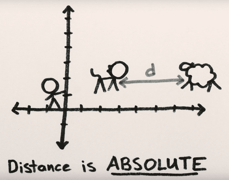

Perhaps not the snapshot you would expect from a video on SR. :wink:
(I know, I am nitpicking ... :rolleyes:)
My guess is in the next video he is going ro replace “distance” with “spacetime interval.”
Oh no doubt. I just found it curious.
The decision to do it that way will probably confuse people. But I suppose if he presents it right and they really pay attention it might work. I think he should have specified he was working in the rules of Euclidean geometry. Maybe. Then again maybe that would cause confusion, too.
