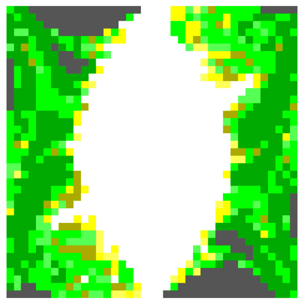

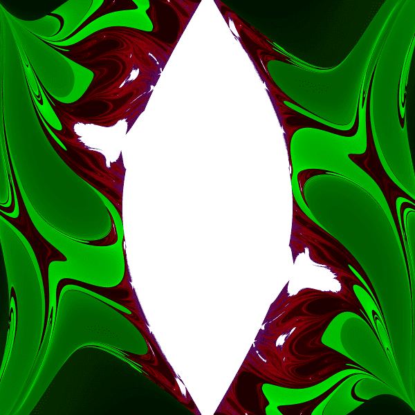

I've successfully modeled a quadruple linked pendulum in Mathematica. I've done a few interesting things with the simulation. I've shown angles vs. time, and how a tiny change in initial conditions result in a completely different, unpredictable path for the masses of the pendulum. I've shown how the time for the farthest mass to "completely change path" itself changes with initial condition. I've shown how the "time for the farthest mass to flip" changes with initial condition. Now I'm plotting something like this:
Wikipedia explains this as follows: "Graph of the time for the [double] pendulum to flip over as a function of initial conditions" (see https://en.wikipedia.org/wiki/Double_pendulum#Chaotic_motion for more details). Now I've replicated this quite well (this is for the double pendulum):
although it looks upside down in mine...not sure if I've reversed something...hmm.

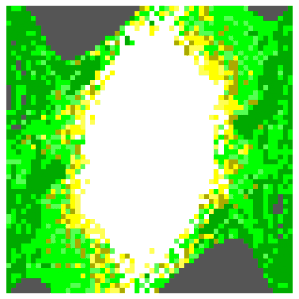

Anyways, I'm looking for similar patterns in the quadruple pendulum. The biggest caveat is that there are now four initial angles to change, and plots above only have 2 dimensions. So I've been playing around with which of the two to vary, and which two to leave constant. I've also tried setting all four initial angles to vary with only two angles (like theta1 = theta3 and theta2=theta4). I haven't been able to get anything interesting to show up, except in the case where theta1=theta2 and theta3=theta4...which is basically like a double pendulum:
and it's not a whole heckuva lot different. (It also took about 30 minutes to draw that.) It's less symmetrical, which is expected.

Sorry about my late reply. The only other language I've done is Java and that was years ago. I've forgotten a lot. I let it run on Mathematica for a couple hours and it was less pixelated, but nothing close to the original image I posted (the one from Wikipedia). I managed to find some interesting ones, and wrote it up in an article.
